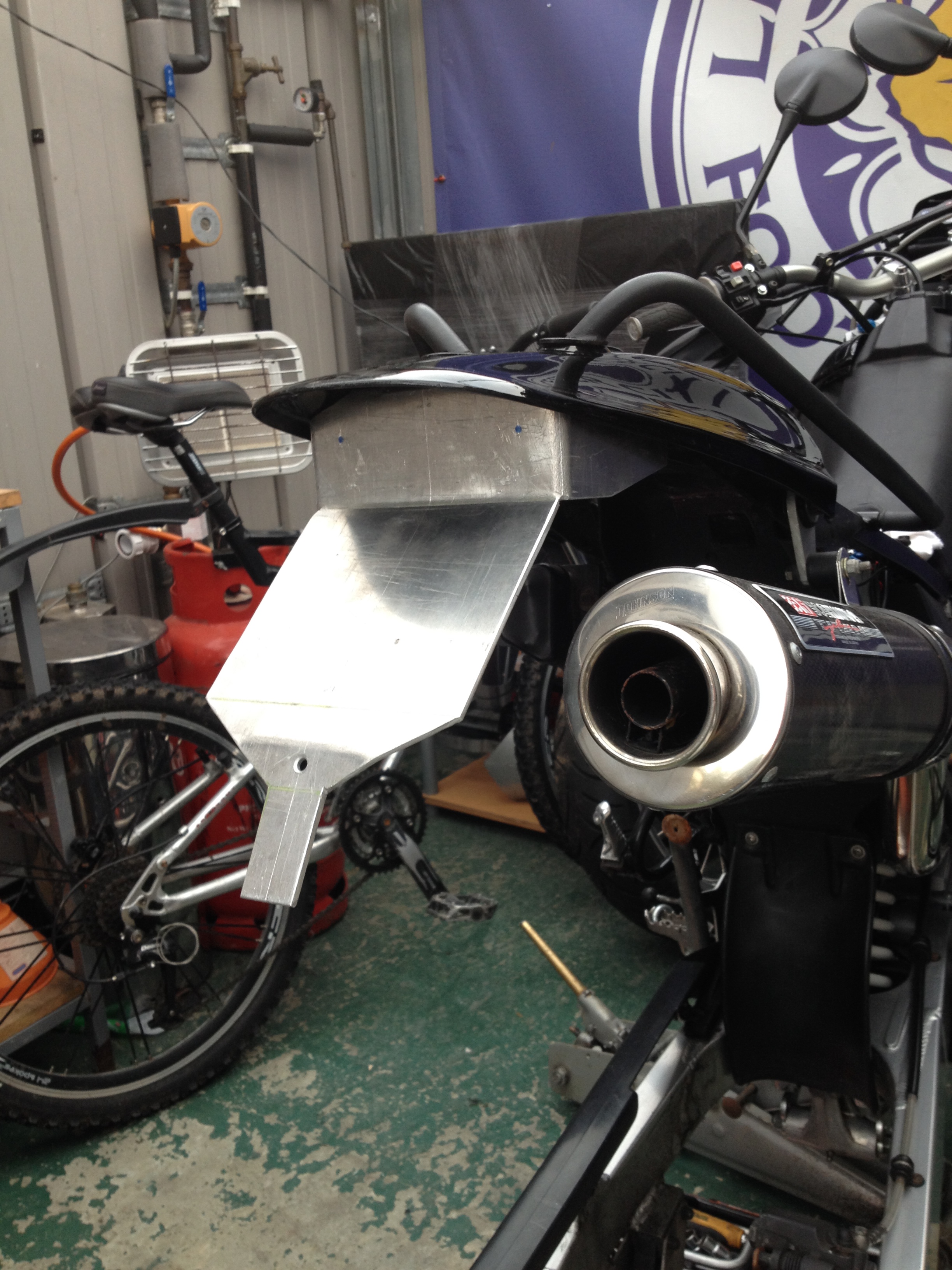

So i got so sick of looking at my loves rear end so i thought i would take it on a slimming exercise.
like all my projects i made two,,so i got one spare ??????
i dont want to clog the site up with loads of photos so
I'm in the process of making a video for this one so ill post it asap.
New baghira tail tidy with carbon wrap talon led indicators and led brake light

Nice Den
Thinking your a bit handy with the metal work!

Very tidy, where did you get the brake light?

Postby den » Wed Apr 23, 2014 3:51 am
[quote="Glidd"]Very tidy, where did you get the brake light?[/quote
got everything from ebay.
alloy plate £10
brake light ,£7
indicators,£40 set of 4
led flasher relay .£2.50
carbon fibre wrap,,£4 worth

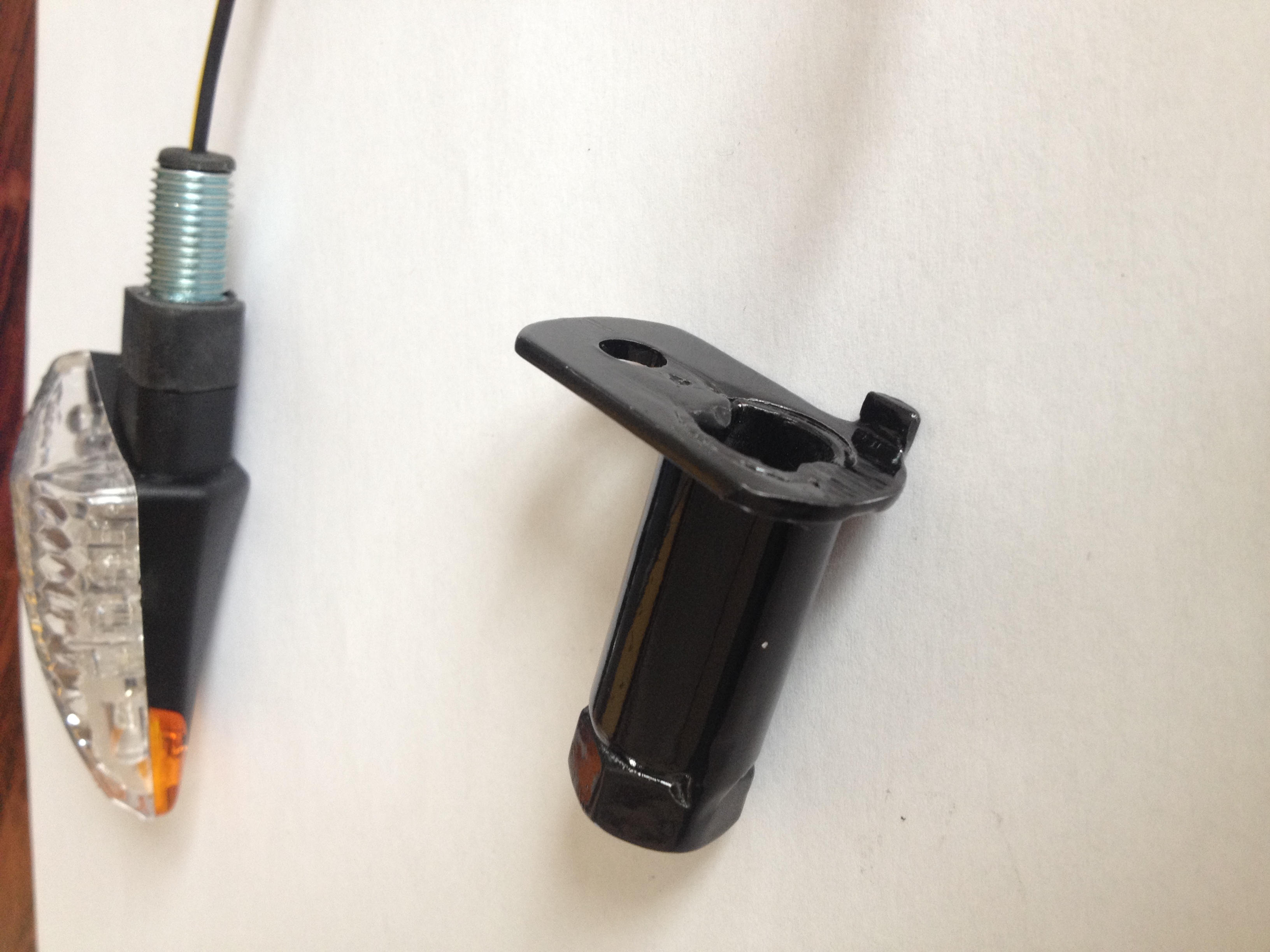

front led stem adapters (home made)
fabrication, whole weekend,

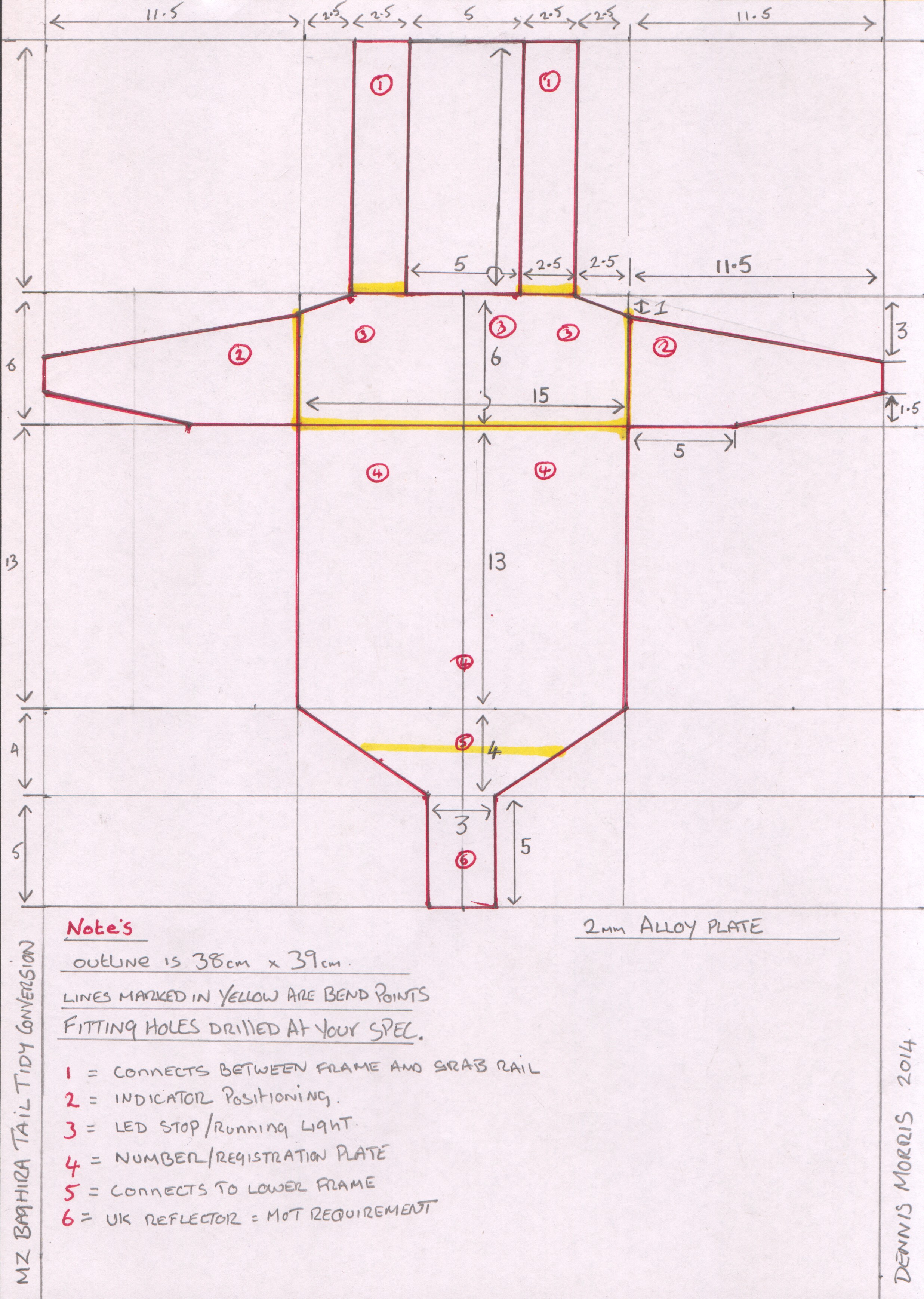

Postby den » Sun May 04, 2014 1:17 pm
