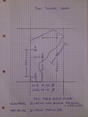

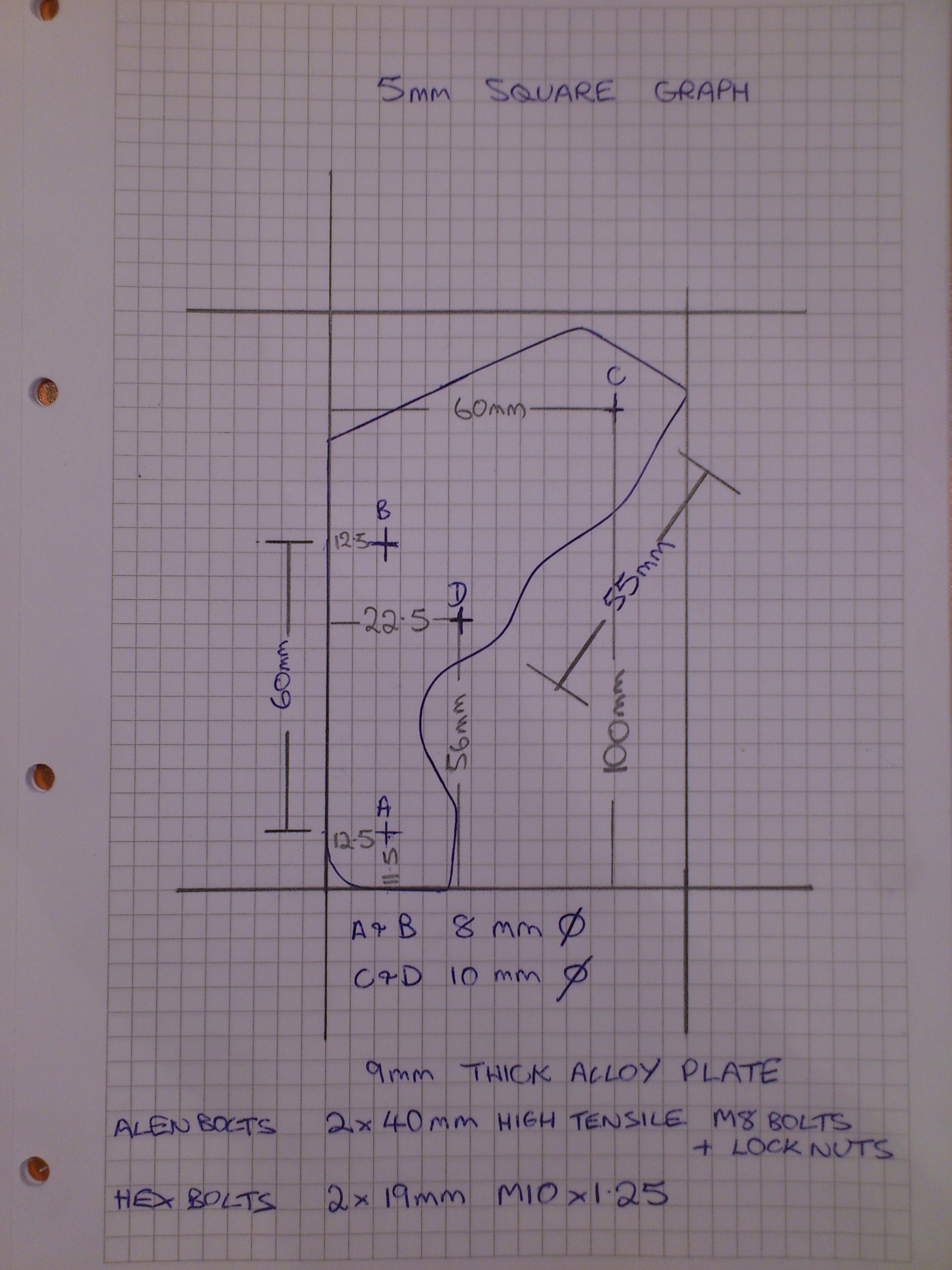

For all that requested a template here it is:

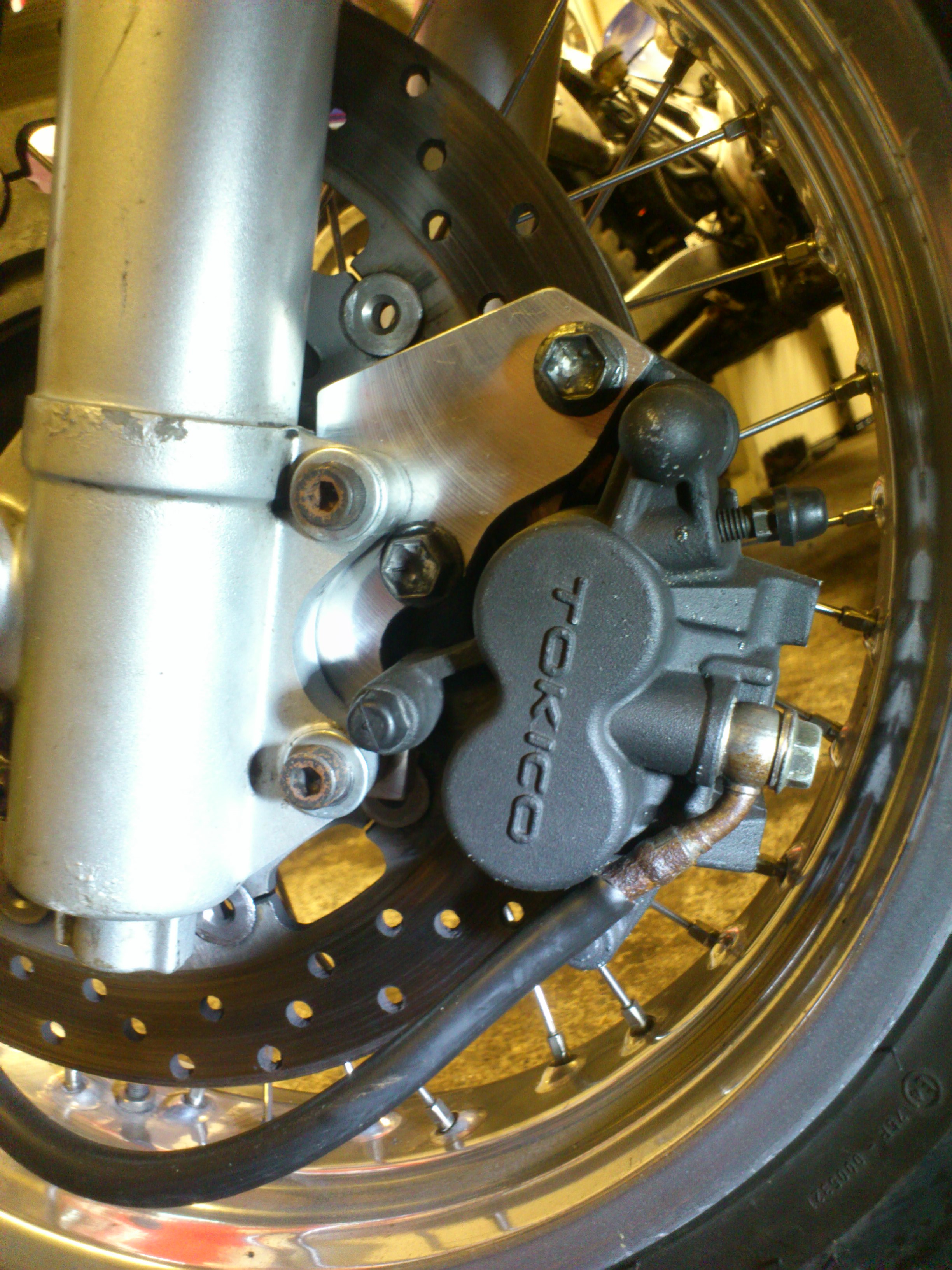

This is to suite a K5 or K6 650 Suzuki (arse) Bandit left hand Tokico caliper (non ABS), a cheaper and easier to find alternative to Brembo.
It perfoms much better than the OE Grimey thing even with the original master cylinder.

Tip for that....buy a windmill. If you work it right you are nearly always on different floors :lol: Hope she didn't read that.....Nice job too I guess the trick is centering the caliper over the disc right?

Yep the trick is to get the full area of the friction material of the pad over the braking surface of the disc.
