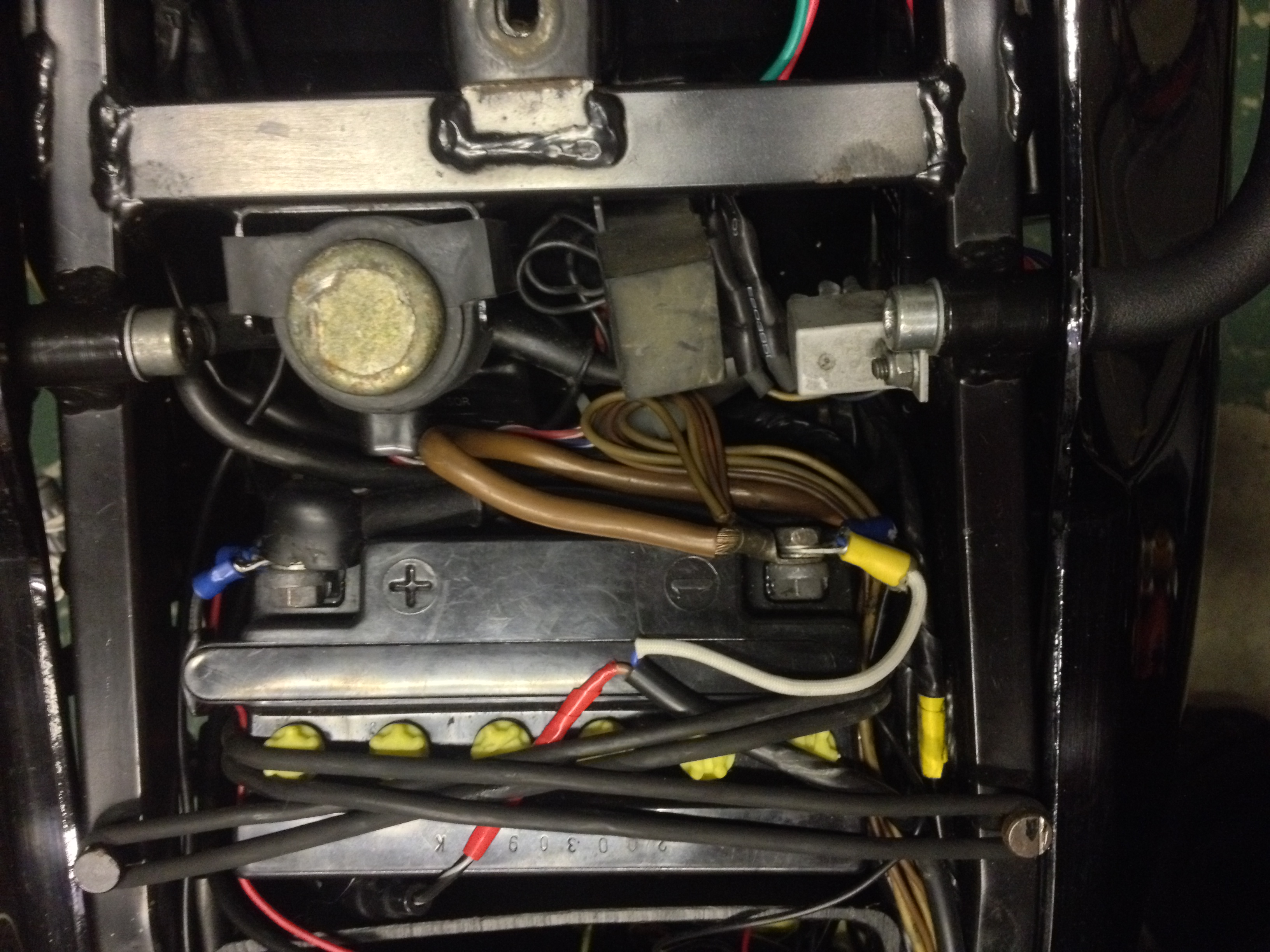

Can anyone show pictures of the wiring route around the frame of a Mastiff and how it attaches?
There are what appears to be, for want of a better word "Nail heads" attached to the frame at various points. I am sure there must be clips that attach to these but cant find anything corresponding to these on my parts list.
With everything freshly powdercoated my "bike in boxes" is now returned to a rolling chassis and I would really like to get this next detail right.
Regards Allan

by breakwellmz
Guido wrote:Can anyone show pictures of the wiring route around the frame of a Mastiff and how it attaches?
Regards Allan
Are these any help?I took them today when i was out in the garage-

yep thats the sort of thing I was looking for could do with a peek where it runs under the tank and through the back of the main frame into the sub frame CDI area if anyone can help?
Still looking for a source for the plastic clips that attach the loom to the frame or their part Nos. Seems to be the only item not shown in the parts manual!
Ian from Grahams is on Holiday at the moment and I am sure even he will struggle with out the Nos. they arent even shown in the diagrams I have
Thanks and regards Allan
