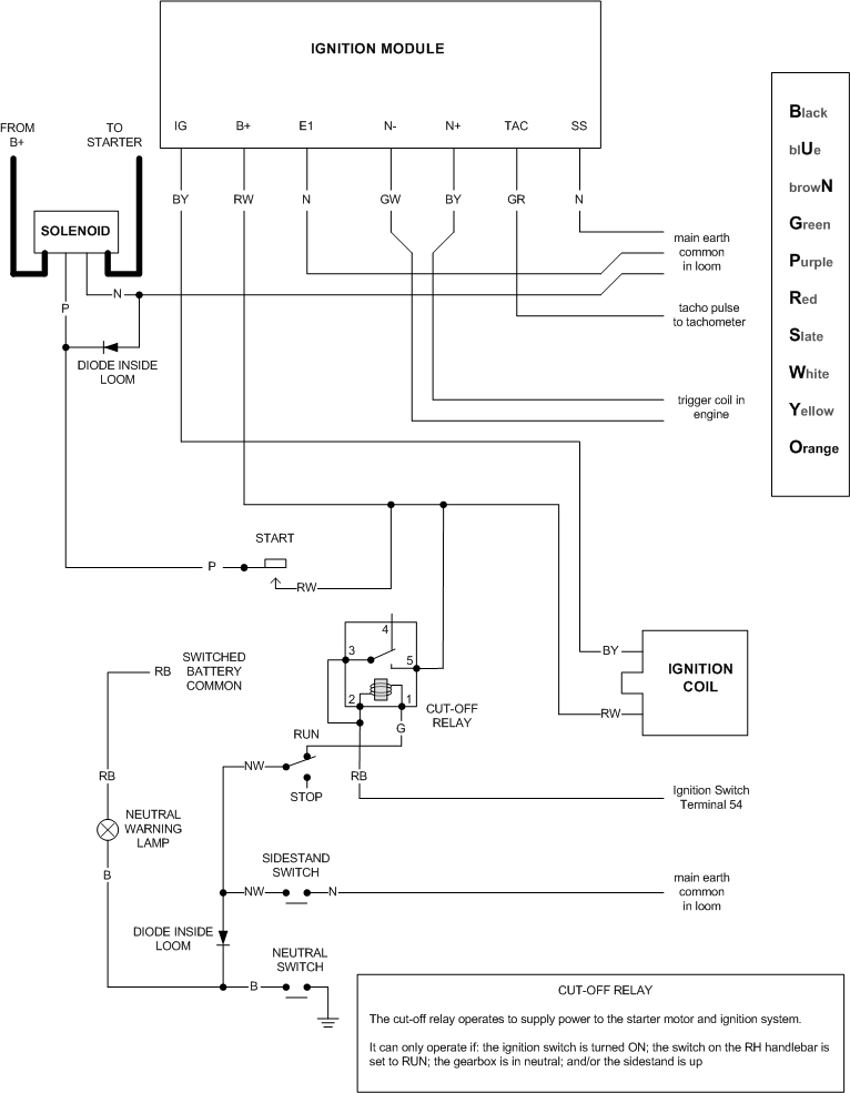

read about the relay 19 problem
ever thing on the bike runs through it and may be making you cut out
and here is a drawing of it
click on drawing to make bigger
if its going bad it can be buger
drawing by tony idle

Postby givusago » Sun Oct 05, 2014 6:18 am
Read through them. Thank you. There was a thread before and you suggested a halfords part that would be a suitable replacement relay. Could i have the link please. Maybe replacing this part will help. The side stand switchlooks good but if the relay is old could be faulty.bikes done 22000 miles so a spruce up may be in order.

Postby DAVID THOMPSON » Sun Oct 05, 2014 10:24 am
i cant find it either
its the relay they use to switch extra lights
the one with 5 pins

It seemed to be the kick stand switch. I disconnected the wires from the stand and tied them together. Its been working fine ever since. :) :) :) :) :) 8)
