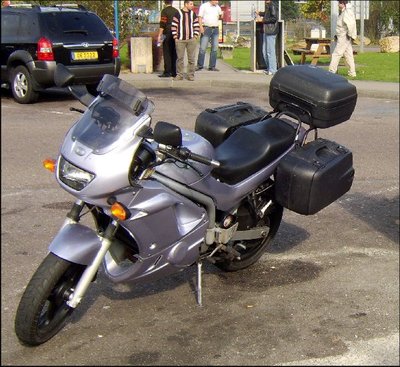

As for the bags, go to Hepco & Becker's website http://www.hepco-becker.de/_eng/frameset.php click on 'worldwide' and select the importer in your country. The standard bags are 30 litres, but are a bit small so it's worth paying a bit extra for the 40 l ones.
The standard hardware for mounting the bags is an MZ part, so should be available through Graham's. However, Hepco also do a different set of hardware that includes a rear rack, part no: 650741.0001
This is my Traveller with H&B hardware, and 40 litre 'Junior' bags and topcase.
Norman
