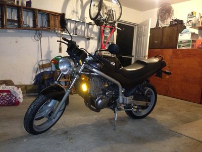

I just picked up my first bike, a 1995 MuZ Skorpion Sport w/ 9800 miles. I was looking for an entry level bike and happened to spot this gem locally. I didn't know anything about them, but after a little research I figured it would be a decent beginner ride. It wasn't running when I picked her up, but a carb cleaning, spark plug and new battery and she purs like a kitten. Currently has a Mikuni TM42 single carb and Dale Walker HoleShot pipe. Sounds great!

yours is a Tour version going by the bodywork and seat...mechanically identical to the other Skorp models....
TM42 ...NICE, many on here have wished and experimented to improve on the stock set up...Holeshot pipe does sound good..have one on my Sport.will be going to
