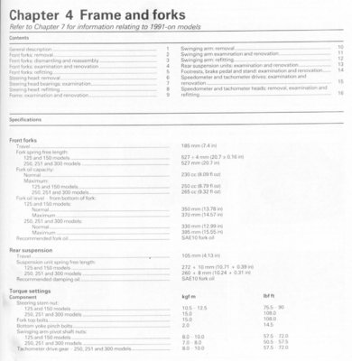

G'day All, My but my learning curve on the MZ is growing. What length is the standard hydraulic cable for the front brake? What rebound is expected from full down to full up? How do I check the volume of damping oil in the forks (drain and measure?)?

Arthur, I don't know the answer to all your questions.
Haynes say:
