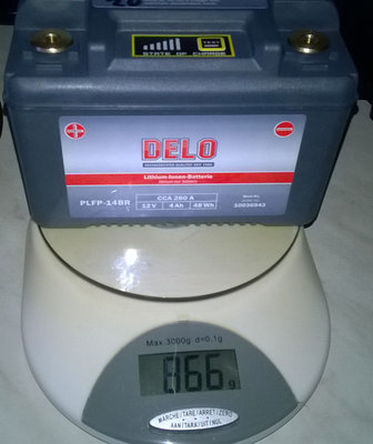

Postby Puffs » Fri Feb 28, 2020 3:17 am
I decided not to pursue the supercap route in favour of the more conventional lithium option, and bought a CCA = 280A lithium battery. It replaces a Yuasa AGM that I used for 9 years. With some tlc that Yuasa would have done more, but I was tempted by the weight difference: 3.9kg vs 0.9kg. While the AGM has a much larger long-term power capacity (10Ah vs just 4Ah for the lithium one), the small lithium one is superior in delivery of instant current = CCA = starting power, which is more important for me (as I never need to start for a long time). The other thing that made me decide was a price cut; the lithium was just €10 more expensive than the equivalent AGM.
Let's see how it performs, and how long it lasts; with just 4 years I will be disappointed.

Postby Puffs » Fri Apr 18, 2025 4:56 am
Just an update: the battery shown still works fine in my Ducati, after now more than 5 years.
