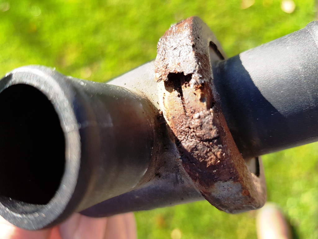

I don't know if any others have suffered from this? The metal band that crimps the two halves of the thermostat housing had corroded and broken causing coolant loss.

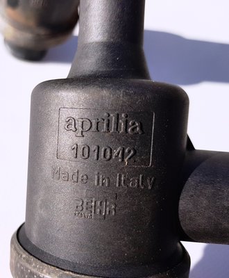

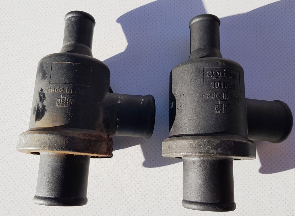

This part is identical to the ones fitted to many of Aprilia's models and has the same operating temperature.
