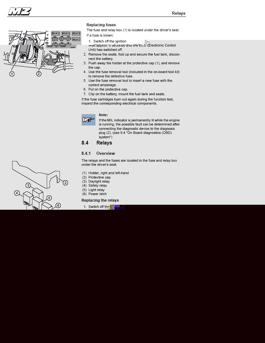

Postby DAVID THOMPSON » Wed Dec 26, 2007 5:26 pm
here is the page on fuse and relays
check all fuses and then the relays
relay 6 is a good bet just from its name
NOTE CLICK ON PICTURE THE SITE CROPS IT >>FULL DISPLAY BY CLICKING ON PICTURE
