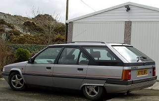

You may well laugh - but I run my ancient diesel Citroen on cooking oil ....................
.......................and it runs perfectly at a fraction of pump fuel. :twisted: :twisted: :twisted:
.......................and it runs perfectly at a fraction of pump fuel. :twisted: :twisted: :twisted:[/quote]
How old is that ancient diesel Citroen ?
It's got a lot of glass and look real clean.
