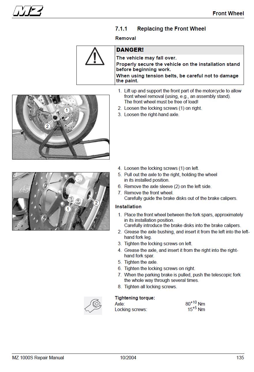

I removed the calipers to take off my front wheel today and ran into this problem.The axle bolt is threaded on the left hand side.How do you hold that ?
Pinch bolts loose and the axle bolt just spins when I turn the right side nut. see picture,thanks,john I can't read German and can't locate my CD...HELP
John Lennon

Postby tomtom » Thu Apr 01, 2010 5:08 pm
keep the left hand pinch bolts tight until you undo the nut on the right as its just a sleeve on the left side.
from manual
Lift up and support the front part of the motorcycle to allow
front wheel removal (using, e.g., an assembly stand).
The front wheel must be free of load!
2. Loosen the locking screws (1) on right.
3. Loosen the right-hand axle.
4. Loosen the locking screws (1) on left.
5. Pull out the axle to the right, holding the wheel
in its installed position.
6. Remove the axle sleeve (2) on the left side.
7. Remove the front wheel.

Postby djsbriscoe » Thu Apr 01, 2010 5:24 pm
Hi,
Picture of page from manual
1000s Front wheel removal
David.

Postby iceman » Thu Apr 01, 2010 5:45 pm
Tom,David,
Thanks a lot that helps me out.I did re-tighten the pinch bolts on the left figuring it would hold it .But when it wouldn't budge I stopped and looked at my German book. :shock:

Postby boilermaker » Fri Apr 02, 2010 6:46 am
Iceman/John
What the manual page does not make clear is that when you remove the front spindle/axle the fork legs can compress independently and the bike falls off the stand! I had to lift a friends bike off him when this happened. If you have a rear end paddock stand then put the bike up on this before using the front wheel stand. I think the reason that MZ do not emphasize this point strongly in the manual is because the factory type stand actually locates in the base of the headlock tube thus lifting the machine from the correct place. This situation actually reminds me of an incident years ago when I was asked to supervise the recovery of a downed helicopter on an offshore construction barge. I arrived on site to find the rigging crew ready to lift the aircraft using webbing straps slung under the fuselage. It had not occured to them that the threaded hole in the upper face of the rotor head was for an eyebolt carried in the aircraft toolkit, thus the aircraft was to be lifted at the point at which it usually lifted itself in operation!
