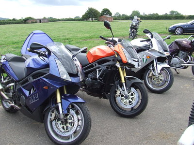

Alex, the engine will run on 1 cylinder but as yours cuts out completly on both it's a little different to my fault. When you get a code put it on the site, i have a factory manual and can tell you what it is. There at least 5 MZ's in the SW as I have seen another orange SF in minehead and Taunton last year. We actually got 3 together at westrnzoyland a while back.

MJ310 - Other than at Graham's I have never seen so many 1000s together as you got at Weston Zoyland! Mine is a blue ST and the other ST in Yeovil has been done in a blue/silver scheme like the original press release shots.
