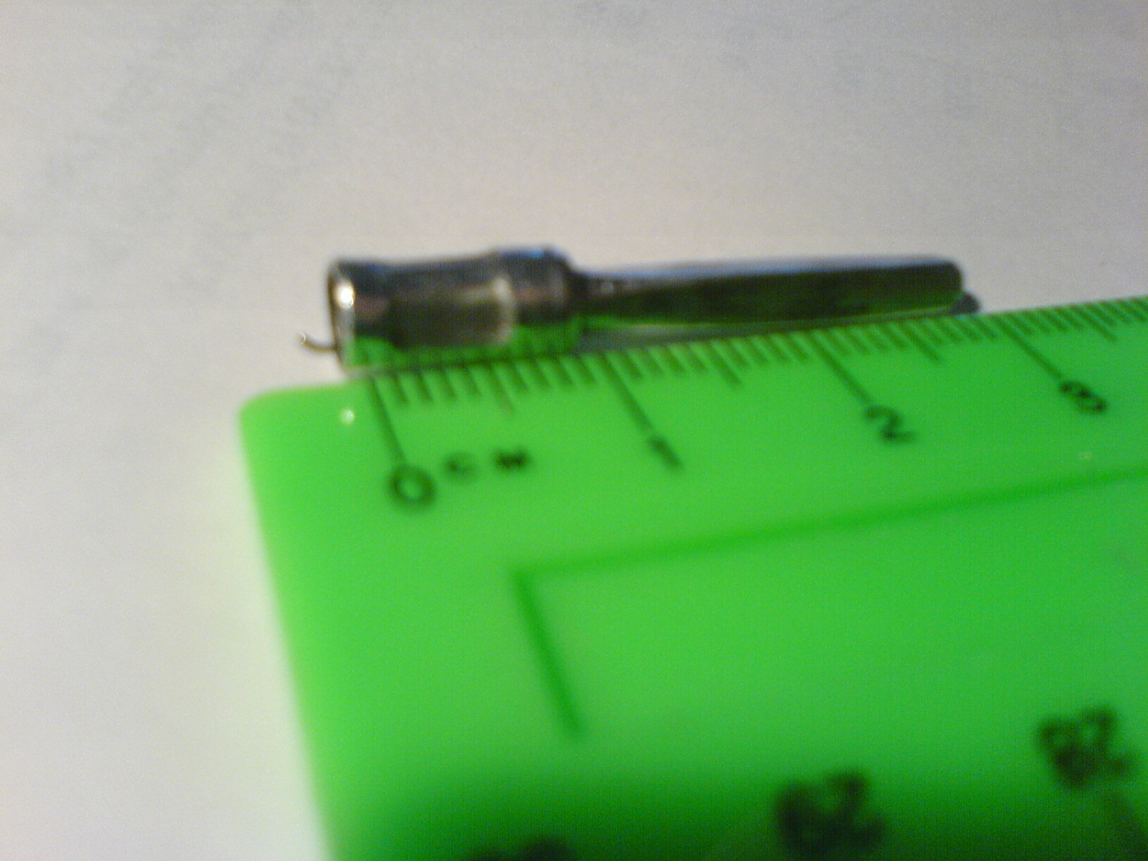

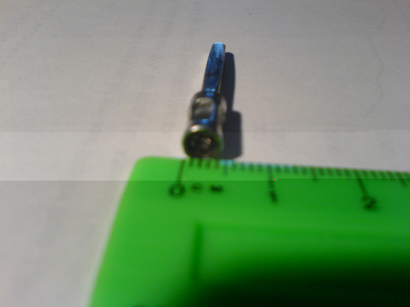

After had my tires replaced and it wasn't the hub end, got around to pulling the speedo cable out at the top and there's a loose pin which has obviously sheared (see below). Is this something I can just get a new cable for and would you chase a wreckers or other supplier?
thanks
Andy

Postby DAVID THOMPSON » Sun Dec 02, 2007 1:49 pm
looks like a new cable is needed
any one know the yamaha part number for andy
as he is in Perth, Western Australia and a yamaha part is easer to get a hand on
than an order to the uk for oem
