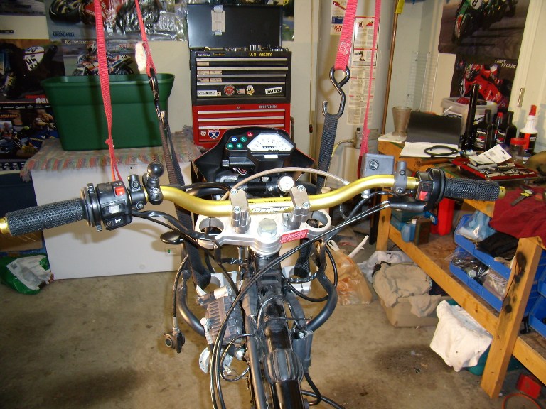

I just put on Pro Taper Contour CR High bars. The standard 7/8 to 1 1/8 bolt on mounts worked perfectly. If the CR High bars worked, I think any of the bends will. I must have moved the bars several inches back and up and had zero issues with cables/lines, they have plenty of slack in them.
Can post pic later if you'd like.

Postby kman.45 » Tue Mar 20, 2007 1:09 pm
Oh, well here they are prior to putting everything else back together...
