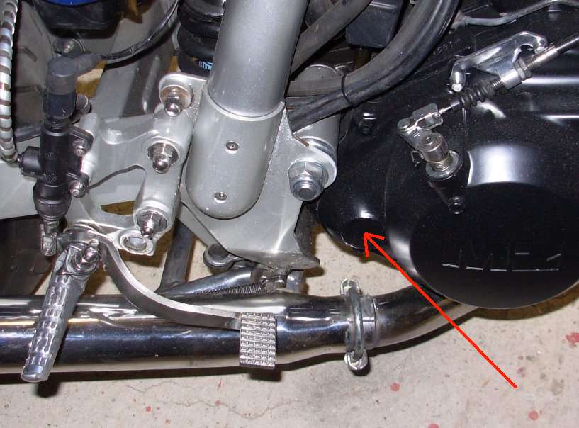

Re: Kickstart
Postby breakwellmz » Tue Mar 31, 2009 2:28 am
Looking at the r/h casing of the MZ last night,i can see the "vestigial"(?)remains of a kickstart shaft output boss,behind the brake pedal.I used to regularly start my old 500 Rotax MZ on the kick from cold,in order to "save" the battery, no problem.Later on added a flywheel weight,which made it even easier!
Re: Kickstart
Postby Linegeist » Tue Mar 31, 2009 6:43 am
Having just wandered out to the workshop and gazed, coffee in paw, at my Skorp, it occurs to me that I'm going to need one hell of a long kickstart shaft to clear the rearset, brake pedal & exhaust.................. :?
I have a sneaky suspicion that Zschopau didn't just leave the manual starter out of the Skorpions just for cost reasons. :( :( :(
The brake pedal will have to be re-engineered and the footpeg refitted so that it folds clear of the kickstart's arc of fire !!!!
