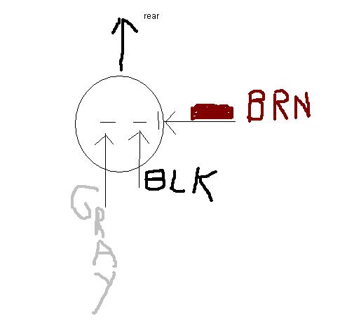

hi all got my rt125 going at last, changed the wiring loom after found earth fault, but cannot remember the way the wiring went to the flasher unit and rear light (colour coding) I have a grey and brown and black on one section then a brown and black /blue one and black/ red one on another then brown and black with white on it to both indicators havent got wiring diagram to look at (one thats for the non electrical people that is like me)

I take it you want pictures (I have an SM, which should be the same). All lights work so must be okay.

Postby timebandit43 » Thu Jul 02, 2009 1:03 pm
yea some pictures would be great got a wiring diagram but that aint 3d lol so know the colours but not which connector to put them too. thanks jamie your a god send

Re: mz rt 125 help please
Postby DAVID THOMPSON » Thu Jul 02, 2009 9:10 pm
the rear lamp the run lamp is the dimmer one
the stop is the brighter and all German wiring i have seen brown is ground
Postby Jamie » Sun Jul 05, 2009 3:25 am
I hope this helps.
The right indicator wires on mine are a green/black wire, and a brown wire.
The left indicator is a black/white wire and a brown wire, but these two are bound together at one point with a piece of shrinkblack plastic.
Does that tie up with what you have?
The rear light assembly is 3 wires, brown, black and grey, on mine these then join to three other totally different coloured wires, which go to the light itself.
Hope this helps
