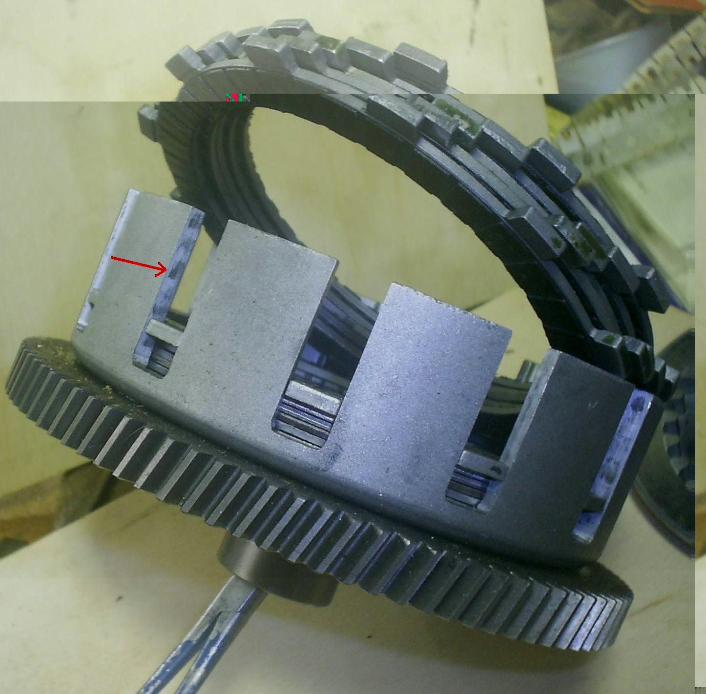

the edge of the basket where the disc ride is ruff and the plates can not move free when the springs push them
they will hang up and twist and not move even
also change the oil in tranny if it been setting unused --old oil does not help
the basket below is from a mz rt125 but they are almost all the same
see scuff marks at the red arrow when this edge becomes ruff things do not work very good..
also consider new springs if its an older bike
on the 2 stroke mz i think there is a worm gear type thing that works the clutch
it runs in the alum..case and may need lube
click on picture for big view
i think this is one of the best pictures i have ever taken with my digital camera
cl basket_rt125.JPG (170.64 KiB) Viewed 1631 times
