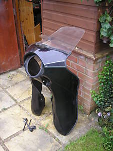

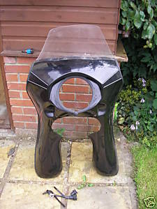

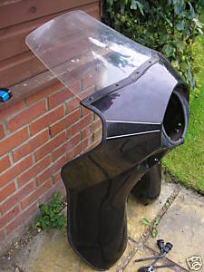

I have just aquired a faring from ebay. I bought it for the above machine. I think it may not be the correct faring for the bike, because depending on its position, it either obscures the headlight, or the clocks. It always obscures the indicators, and cannot be put even close to the bike with the mirrors on. Does anyone know how to identify the correct faring? Is it likely to have came off an ETZ 250? The seller had one.

lot of 251 mz had a faring made by this company or someone they bought out looks a bit like it
may fit yours but you need to fab different hardware and move some stuff
engine noise behind it will be high
head lamp mounts in it and the speed o probably also
