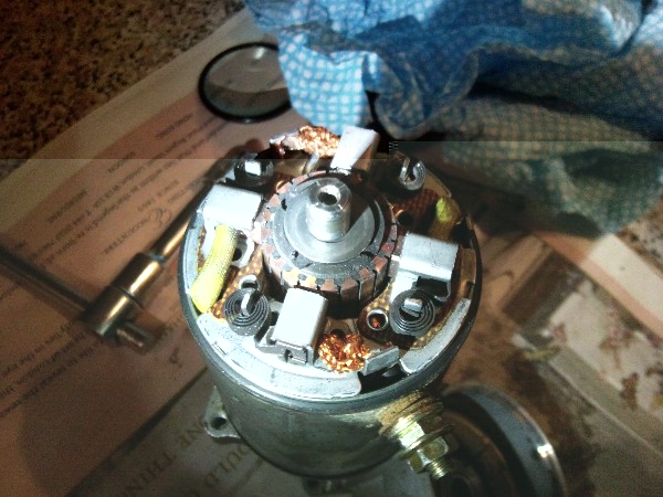

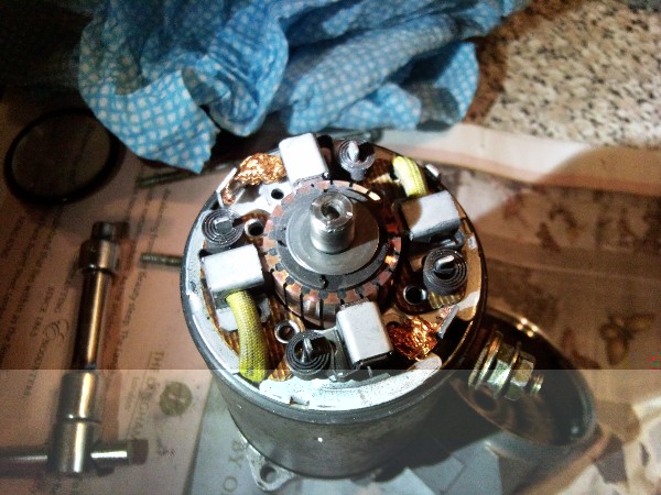

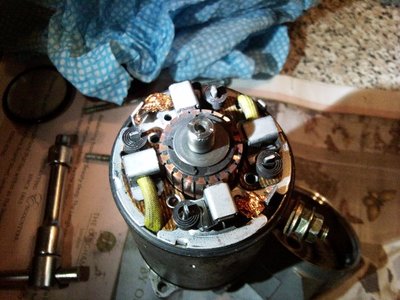

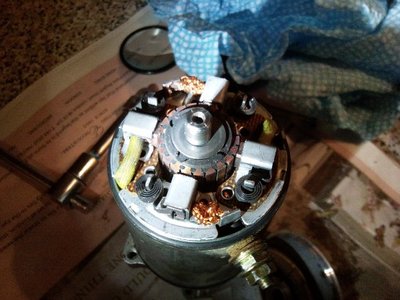

Hi,
Does anyone have any knowledge of how the brushes and commutator should be on a Mitsuba SM-13 starter motor?
Should there be carbon where the brushes actually come into contact with the commutator segments? On my starter there is no carbon at all.
There is a dark ring on the end plate where it appears some material has been flung onto it.
Any thoughts or advice?
Thanks.
David.

Dave, the pictures show how a starter motor commutator should look. Simply put,the brushes supply current to different windings, which generates a magnetic field. This field interacts with the stationary field, (usualy magnets in the casing) causing movement, this rotates the commutator so a different set of coils are under the brushes, hence the different copper segments. If it had plain sliprings, as in a 2 stroke alternator, there would be no movement when a current is applied.
