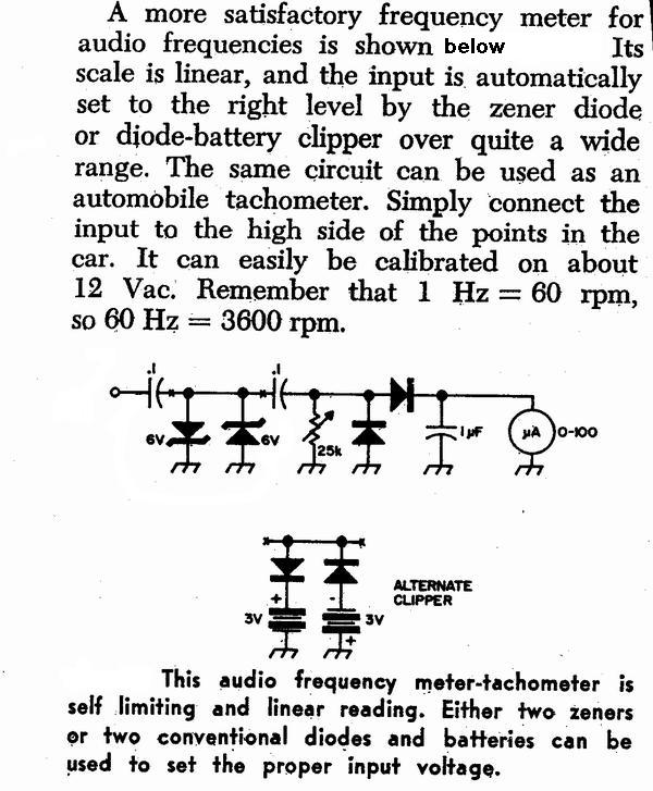

Postby DAVID THOMPSON » Sat Apr 30, 2005 5:08 pm
HELLO
I WAS DOING SOME READING AND FOUND THIS IN A MAGAZINE
FROM 1968
SOME ONE WITH ELECTRICAL KNOW HOW REVIEW IT AND SEE
IF YOU THINK IT WILL WORK OK
AND POST YOUR COMMENTS HERE
I THINK IT WILL WORK BUT DON'T HAVE TIME TO BUILD A TEST MODEL
AT THIS TIME :-D

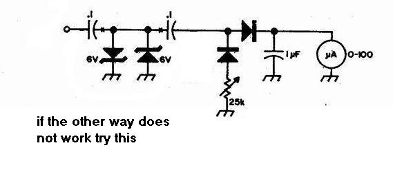

after looking at this there may be an error in the original drawing
i have had error problems with some articles in this magazine before
i think there drafstman was not an electrican
rev
tacha
click on picture for full view site crops it till you click on it

if the other way does not work
try this
tach home made update.jpg (15.6 KiB) Viewed 3030 times
DRAWING OF HOMEMADE TACH.
tach home made jpeg.jpg (87.25 KiB) Viewed 3046 times

Postby keithcross » Sun May 01, 2005 4:47 am
This should work OK, but why would you want to do it, there are plenty of tachometers available that will fit the MZ.
Making your own could give lots of problems, such as locating a suitable meter for this circuit to drive.
Keith
