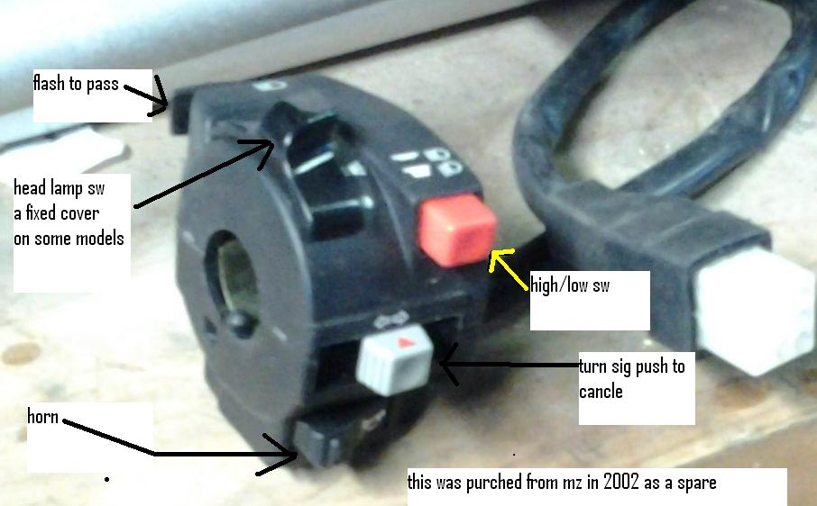

Postby DAVID THOMPSON » Sun Feb 15, 2015 6:22 pm
on the left side some have a headlamp on off switch
on my rt125 from 2002 it was a locked dummy on all the time
due to a lack of dealers back in 2002 i ordered some extra stuff
the spare looks the same but the switch works its not a dummy

Postby Agronski » Wed Mar 18, 2015 4:25 pm
Got a photo? Because even on the "Luxus" model there should be only one switch on each bar: the indicator switch on the right (three position toggle) and the light/horn switch on the left (2 position toggle for high and dip beam, plus 2x push-buttons for horn and high-beam flash) - you can double check by looking at the simplified wiring diagram: http://www.sweller.co.uk/mz/images/wr_tsd.gif
If there are other switches, they're after-market and added by an over-zealous owner ;)
The TS150's never came with kill-switches, you just turn the main ignition key off to kill 'em. Check how many low-tension wires are connected to your ignition coil - more than 3 and you might have a problem...

Postby DAVID THOMPSON » Wed Mar 18, 2015 7:48 pm
One problem is these were daily drivers ...and many have been repaired with what ever was handy at the time
from where ever
from 1969 to mid 1980's i had some old bmw bikes that the only way you could tell it was a bmw
is its hard to hide the cylinder heads

Postby suzukix7 » Thu Mar 19, 2015 11:06 am
Thanks guys, that has answered my question. It is the high beam switch!!!
At the time of asking none of my lights were working so assumed it to be a kill switch but now I know it's a high beam switch.
