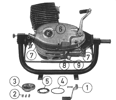

Unscrew the screw that is located on the left side cover of the engine.It is located under the gearchange lever (if you look at the side cover)
It is at "5 o ´clock" under the circled number 6.
http://www.miraculis.de/aw/mz/text/ts251r/14.gif
If the bike is standing on the central stand , the oil should drop out a little bit of the hole. If not, you have to fill up until it does.
