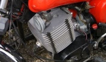

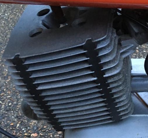

I don't know if you have ever noticed but the aluminum colour of the head is different to the barrel. :shock:
The head colour is very slightly more silvery. Most owners might not have noticed but take a close look and you will see. Maybe the barrel requires an alloy that expands less to keep the liner held tightly, whereas the head simply has to expel heat....I wonder if anyone else has noticed and knows why?...By the way.... I am sure it is not dirt or corrosion differences...
head colour.JPG (20.5 KiB) Viewed 3505 times
head colour 2.JPG (23.15 KiB) Viewed 3505 times
Les

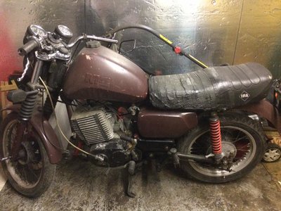

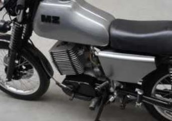

Here below is my bike (advertising pictures, I hasten to add)... The picture of it outside, you can see a difference.. The picture of it inside- it looks no different..
