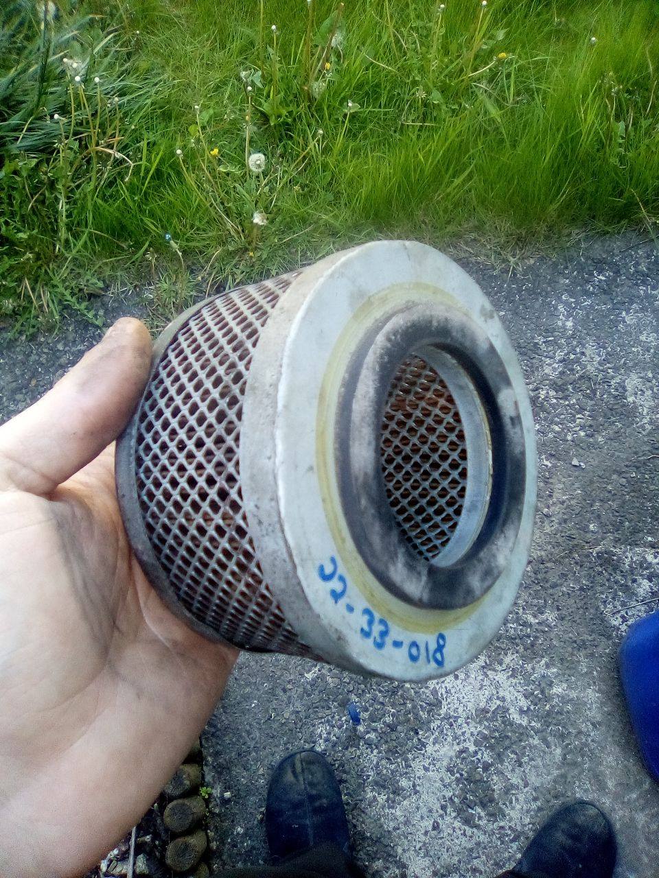

Postby Blurredman » Wed May 06, 2020 12:57 pm
Well- Made the bike richer on the way home, but I could tell it was much worse- so instead I made it leaner than it was before (2nd from the top) and it ran pretty much how it has always been.
Got home and took a look at the filter and it was thus:
It's dirty and very likely very beyond it. I don't know what it is from (if it isn't MZ) and I don't know how old it is either.
I've bashed it on the floor many times and re-installed it. I've also put the needle in the default middle position. Will see how it runs in the morning- If I find the same symtoms as I have recently then I know it's running rich and either leave it in a leaner position until I manage to get a new one, or nab the one from the other bike..
Numbers written on it are part number and not mine.
What intruiges me is that i've double checked for air leaks, and can find no discernable reason why this would suddenly be the issue- after being in there for so long..

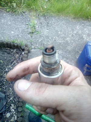

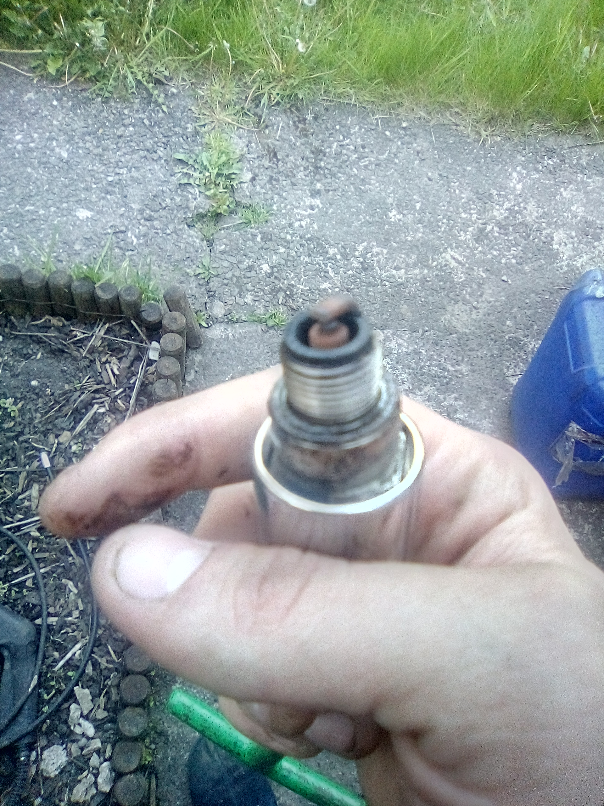

Postby Blurredman » Wed May 06, 2020 1:55 pm
Just for reference, this is the spark plug after 15 miles on the leaner setting ...
It looks lighter than ordinarily, but seems very passable..

Dump that filter!
Re: BVF 30N3
Postby Blurredman » Wed May 06, 2020 3:50 pm
It's the only one I've got at the minute until mz-b get more stock. I'm not paying those e-Bay prices when I have three to buy.
Anyway.. I went out for a little jolly and all seems well! Everything as it was working only a fortnight ago.. happy..!

Postby Puffs » Thu May 07, 2020 2:02 am
yeah but he's right. Get a new one.
Btw, tapping a paper filter doesn't clean it very well. Yes, if there's some course stuff on the outside, you'll tap that off, but not the fines that are inside the paper. And it's those that clog the filter. Best you can try is blowing compressed air against the normal flow, but that too only helps a little. At some stage a new one is in order.
The plug looks fair though.
