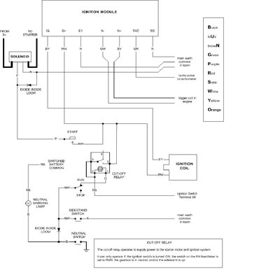

Postby DAVID THOMPSON » Thu Aug 13, 2020 12:55 pm
check relay 19/30 on mz drawings if its contacts stuck it may be the problem
or the start relay may have welded its BIG contacts together
and your battery took a bad hit if this happened
battery may still work but it may be short lived
relay 30/19 has red/black wire /red/white wire and and a green wire every thing in the bike goes threw it
sounds like its contacts are stuck in run mode
click to see drawing larger or download and print a copy
the #1 problem part is stuck
