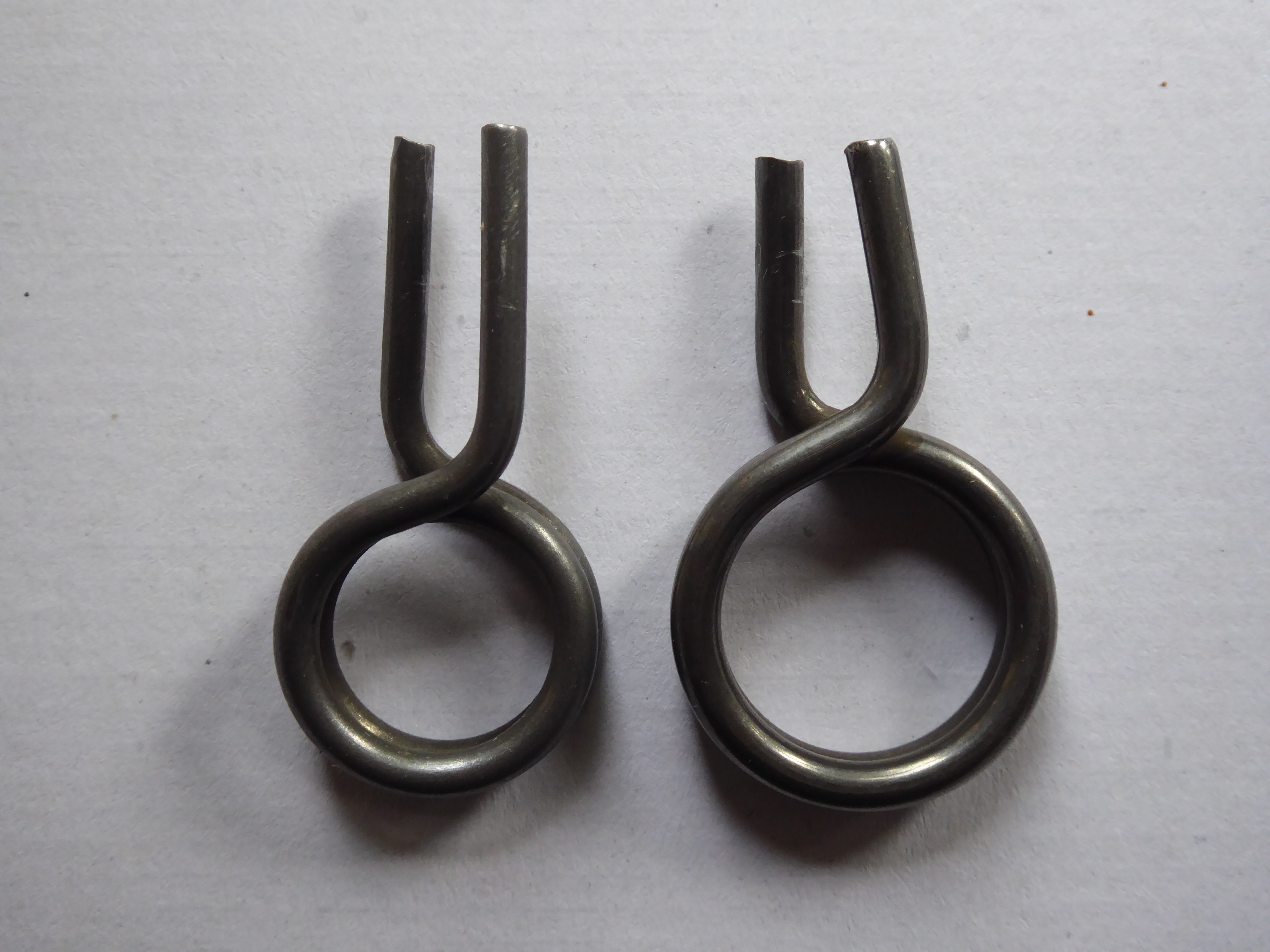

After waiting a month for an order to turn up I find the gear-shift spring (Item: 29-47.006-DDR) is much bigger in diameter. The original (which has done only 9000miles) has a coil diameter of 23mm whereas the new one is 27mm. This results in the spring moving around on the gearshift shaft and also causes the 2x legs to be further away from the locating peg and consequently they nearly miss it.
mz shift spring.JPG (10.08 KiB) Viewed 7396 times
Does anyone now if the diameter was changed in later years or have I been sent the wrong one?

the one you got is for TS 150.

I thought you would like to see the difference. It is hard to believe that such a large well known MZ spares dealer could get these mixed up and then not bother to reply to my 2x emails :cry:
The correct original is on the left. As you can see, the big spring moves around on the selector shaft and it has shorter legs which don't reach the locating peg if the position moves away due to the large clearance of the hole.

The problem with the original springs is that they have a notch due to the production method. On the picture the area where this notch is is marked with a white circle.
You can feel this notch when you go over this area with your finger nail.
This is the weakest point of the spring (a breaking point).
And if it breaks you have to dismantle the whole engine for this little and cheap spring...

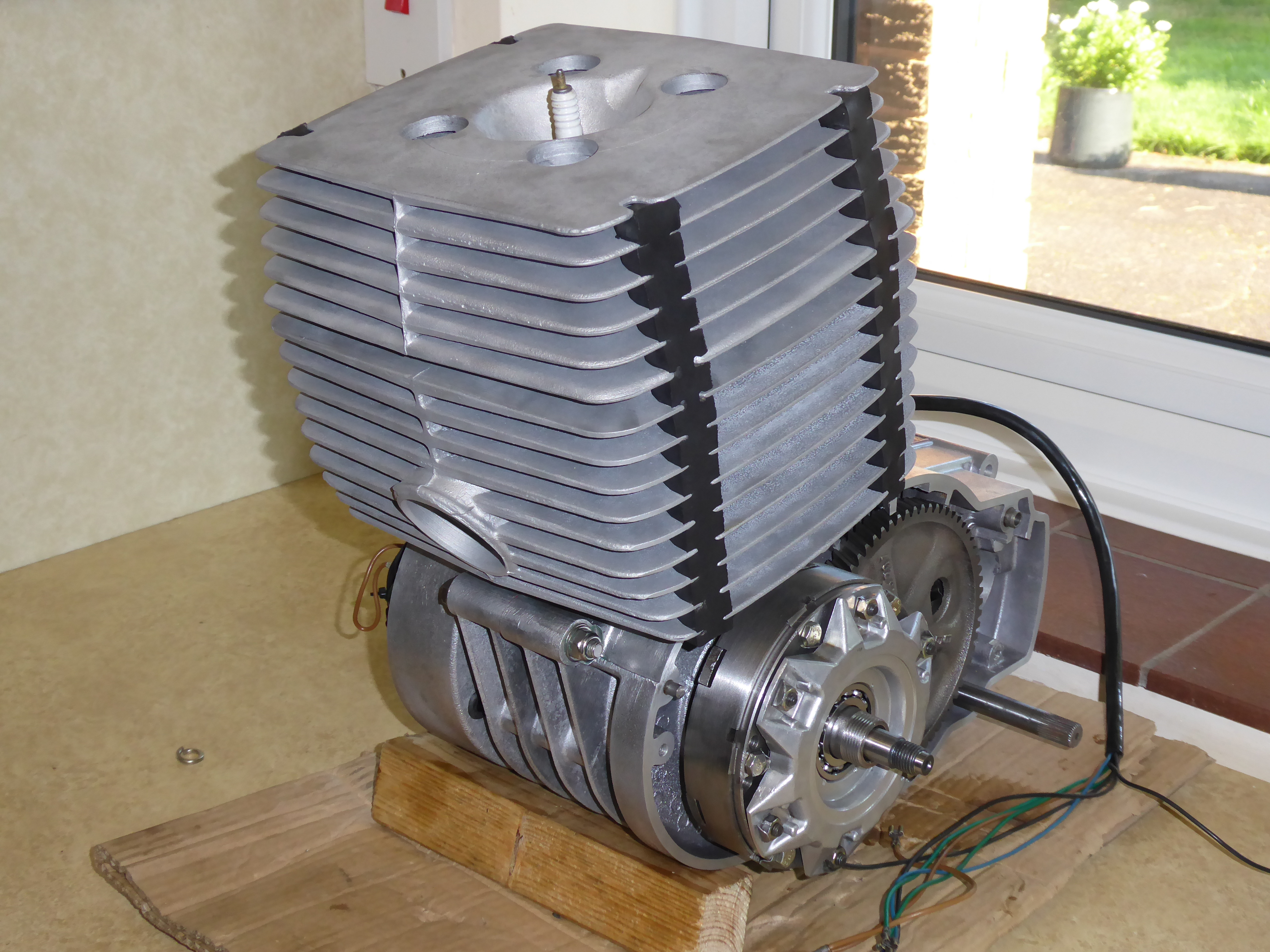

Just thought I'd show the complete engine before fitting it which I have now done as a single unit as per Puffs recommendation. It was quite easy but as usual, if I were to do it again tomorrow it would be ten times easier...Photos of the engine in frame to follow soon.
And YES....it IS on the kitchen worktop. :lol: but I have to to modernise the kitchen later this year :cry:

Well, that looks spotless!
