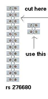

here is picture of the plug solder the ends of wire and place in plug RS 274680
in stock most radio shack stores ... leave rest in with tools for future repair
i also dribble hot candle wax on the connector to seal it from the weather
this is my favorite plug for fixing things
but always tin the wires with solder
the plug
