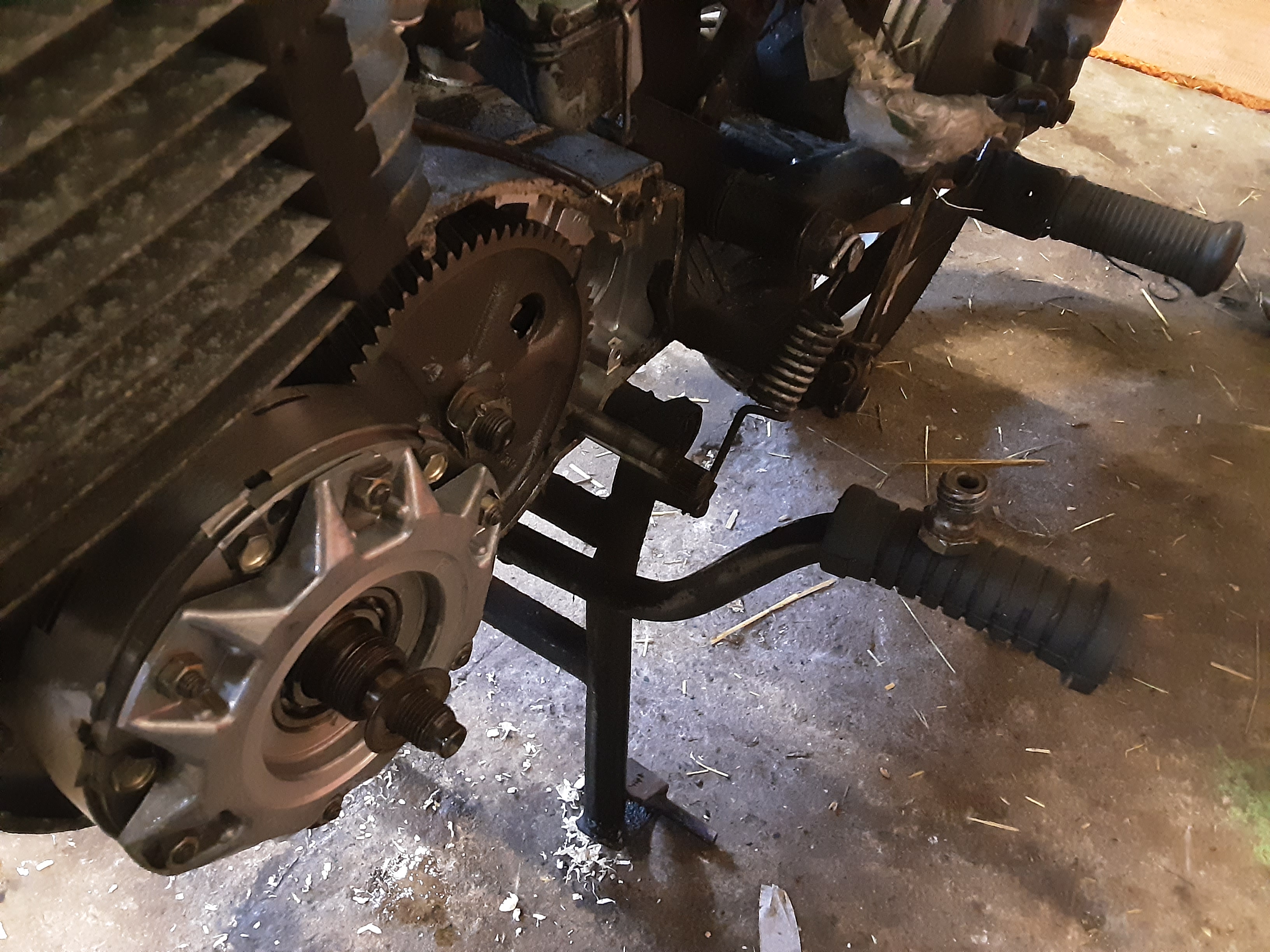

Hi, I'm trying to get the aforesaid off to renew the kick-start return spring. Having removed the 5 screws and removed the (defunct) oilpump and undone the rev counter drive cap the engine cover will only come away about 3mm away from the gasket surface. I don't want to prise it too hard and break something, but something is def stopping the side cover from coming away. It's driving me mad.
I can get the LHS engine cover 3mm away from the gasket surface at the back of the engine at 2mm at the front. There def a gap all the way round.
Help!

On which side does it seem to be stuck? Around the kickstarter or clutch.
Likely the bearing is a stuck on the crankshaft. For that you can make a puller from a flat piece of metal - drill holes where the clutch cover holes are and one in the middle for a screw which will pry against the crankshaft.

Make sure all the bolts are off (5 that attach the clutch cover to the crankcase), plus additionally the tacho drive nut- some people forget this. Normally I have the clutch cable entrance tube attached an with left hand on that, and right hand on the kickstarter, I pull it off thus. It can be a pain sometimes as it is a close fit (ie crank end and gear shifter shaft) not giving much movement. Don't forget the shift lever!

Postby JawasandMZs » Fri Nov 19, 2021 10:30 am
Result!!!!!
Job done in ten seconds!
Thanks again.
