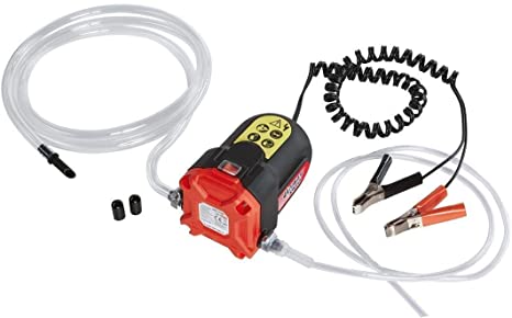

Postby breakwellmz » Fri Nov 27, 2020 10:44 am
I use one of these that came from Lidl, only £10. It`s been used for emptying numerous oil sumps and petrol tanks on mowers as well, brilliant thing.

Postby nice2day » Sun Nov 29, 2020 4:56 am
Thanks for the heads-up on the electric pump. I was keen to buy one or similar but then realised as Puffs suggested they are not specified for using on petrol (gasoline). They suggest Diesel, water or engine oils but NONE (there are scores of them on Ebay) refer to petrol. The reason might be that petrol dissolves many types of plastic quite well so could damage the pump if used for lots of petrol pumping but maybe OK in the short term. The other reason is the fire risk. The shaft seal between the motor and pump body could let petrol seep into the motor and as the the motor is DC it will have carbon brushes that always spark in use. You could find the pump suddenly catches fire.
