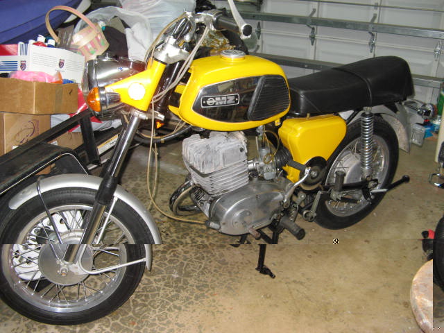

All of you that have sent replies to my fowling spark plug are the best. After having ridden the bike four times the plug remains a tan color. The plug would have fowled out by now and the engine would have quit on me. This is why I always carry a spare plug in the tool compartment. The problem was the seal at the bottom of the choke plunger. I am now going to follow up on the suggestion to clean all of the terminals on the electric charging system. The bike does not spit black oil all over the engine and I no longer have that plume of white smoke!
I do still have some issues. For one, I do not seem to have good power at low rpms. I can not go into forth gear until the bike is at 40 mph or the bike bogs down and starts losing speed. It will not accelerate in fourth below 40. Same with third gear below 30 mph, second below 20. Once the bike is over 40 it will accerate to 50 with no problem.
The other problem is I can't forget to shut off the turn signal or the bike loses power. Here in Florida it is the law that you have the front head light on at all times. I am going to see if cleaning all of the terminals of the charging system resolves this issue. I have heard that the old MZ bikes do not charge well at low speeds. I am also considering wiring in two batteries so that I have more Battery reserve at the lower speeds. I have a spare 6 volt battery.
Anyway, thank you to all that have replied to my post.
Best Regards, Frank

It does sound like the electrical system could benefit from a clean up. If it's any help, I tend to use my headlight all the time & after about an hour at town speeds the bike tends to stall if I switch the indicators on so I can vouch for the weak low-speed charging (even with the rest of the system in tip-top shape & using a long life gel battery from a toy motorbike!)
As for low speed torque, you're not going to get an awful lot better than what you describe I would say. I have a 4-speed lump in my bike & it prefers being in the 5000-7000rpm range, much below 4k & I need to change down to accelerate reasonably well. Possibly yours will get better as the motor loosens up, after all it is barely run in yet.
