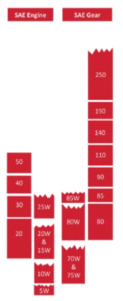

My personal choice for most motorcycle gearboxes is a high ZDDP Classic Engine type oil. EP oils only really come into there own when the gears are subjected to the extreme pressures as produced in hypoid axles and such like. You have to remember that even high powered Japanese engines use just one type of oil common to the engine and gearbox with perfect longevity. ZDDP is an extremely good wear protector especially for rolling or sliding areas such as cam follows and spur gears (straight cut) . The additive "plates" the metal surface and reduces wear enormously.
Don't make the mistake of thinking that the high viscosity number on the bottle of EP oils indicates they are much thicker than engine oils so they must offer better wear protection...No, it is simply that EP oils use a different scale of numbers (see chart below) A 40 SAE grade engine oil is as thick as EP90 and even an SAE 20 compares well to an EP80 gearbox oil.
MY choice is a high ZDDP engine oil such as: Millers Classic 40 or Duckhams Classic 40...or if too much clutch drag, go down to a 30 grade or 20-50 multigrade version.
Conversely if too much clutch slip use a modern motorcycle oil with JASO MA specification as mentioned by Kruh a few posts back.

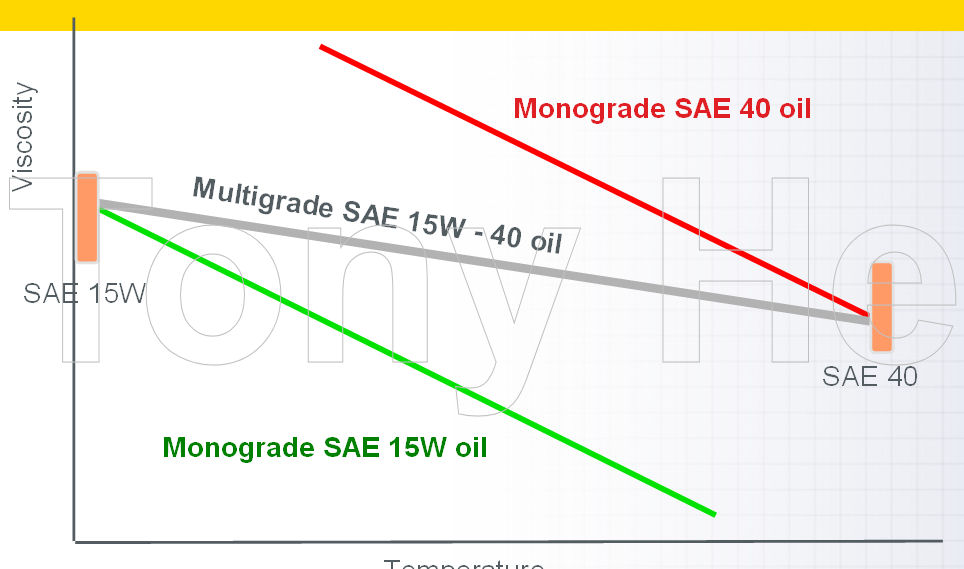

There is a common mis-understanding that multigrade oil thickens as it heats up. Some/many believe the oil is thin at low temperatures and thickens as its temperature rises. This is completely wrong. ALL oil THINS as its heated including multigrade oils...its just that the oil does not THICKEN as much as a straight grade does as it cools.... this is the best way to picture the way it works.
For example a straight 40 grade oil becomes thinner as it is heated and quite thin at 100C. When it cools it becomes much thicker, making the engine harder to turn. Likewise the 15 grade oil will be very thin when hot but when cool is will thicken but to viscosity thinner than the 40 grade will. So by using a multigrade oil such as 15w-40 we have an oil that starts at the equivalent of a 15 grade but has a slope that drops away less steeply as temperature rises...noting it still gets thinner...to the equivalent of a 40 at the same temp.
