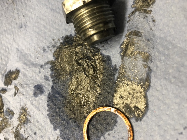

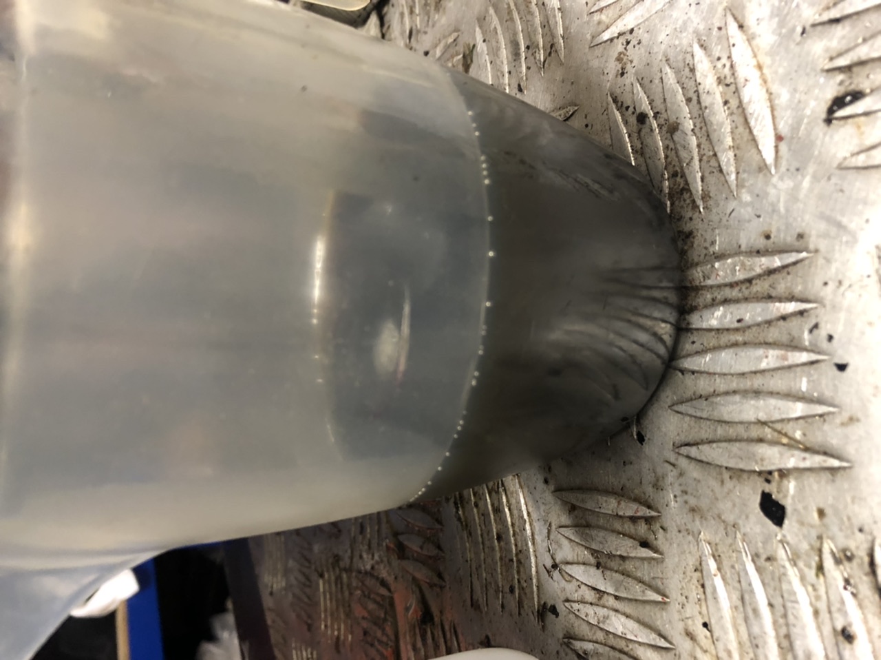

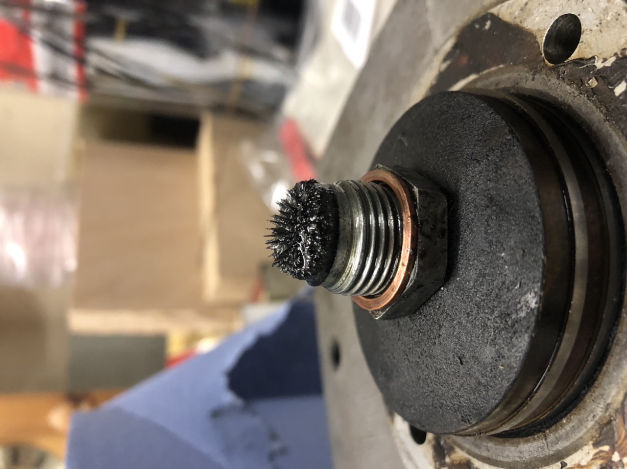

Postby ScotBob » Fri Dec 10, 2021 8:11 am
So I have drained the oil today, see pics: less than 450ml came out so not too much oil, but look at the amount of metal on the magnetic plug and the oil is full of it!!
ScotBob
Posts: 73
Re: ES150 will not run right!!
Postby dave47 » Fri Dec 10, 2021 8:45 am
There are 2 drain plugs, one under the gearbox, the other under the LH cover. Apologies if you knew that. Yes, that is certainly a lot of swarf, but I'm not sure of its excesive.

Postby Blurredman » Fri Dec 10, 2021 9:18 am
dave47 wrote:Yes, that is certainly a lot of swarf, but I'm not sure of its excesive.
It surely is if the oil was changed when he first got the bike and has done only 300 miles? :-D :-D :-D
Is there play in the crankshaft? up/down/left/right?

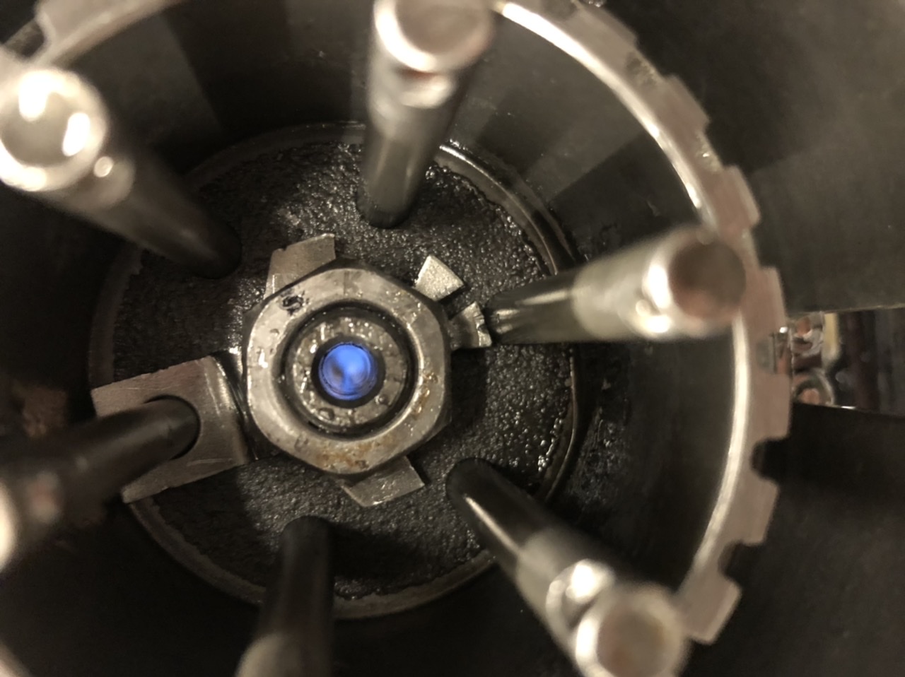

Postby ScotBob » Fri Dec 10, 2021 9:37 am
dave47 wrote:There are 2 drain plugs, one under the gearbox, the other under the LH cover. Apologies if you knew that. Yes, that is certainly a lot of swarf, but I'm not sure of its excesive.
Got them both thanks, just removed clutch cover and seems a bodge job, clutch nut lock washer not fixed as the tabs are broken off:

Postby Gerryman Ts125 » Sat Dec 11, 2021 4:26 pm
Mz TS 125-150 (shared with the Es) same bike, same engines, different bore slightly bigger carb and jets on the 150's, but that is about as much that the factory did. The clutch is internally driven by a chain. When rebuilding the engine, there's lots of small washers bolts can fall into the clutch side. (My ts's both had a habit of bolts and washers falling in) instead of taking the clutch casing off I would drain the oil and all (or most) of the errant bolts/washers would come out either with the oil or on the gearbox plugs magnet. And lots and lots of swarf after about 500miles.. Eeeeekkkk I mean really plenty of it. It looked just like grinding paste. In a way, that is what it was .
As the Mz is really prehistoric, when they were built.
And as said, no seal, I didn't need a Scott oiler on my TS, it had one built in..
Gerryman Ts125
Posts: 130
Re: Mz's will never run right!!
Postby Gerryman Ts125 » Sun Dec 12, 2021 4:41 pm
I forgot to add, that after my second TS 125 was ran in, (500 miles) I got hypoid 80 in my replenished gearbox. After that, I filled it everytime with 20/50 and any new crappy oil. As I replaced the oil every 500 miles. And it looked like I had dragged the magnet at the end of the sealing plug, through the swarf from a milling machines bin :mrgreen: [*]
