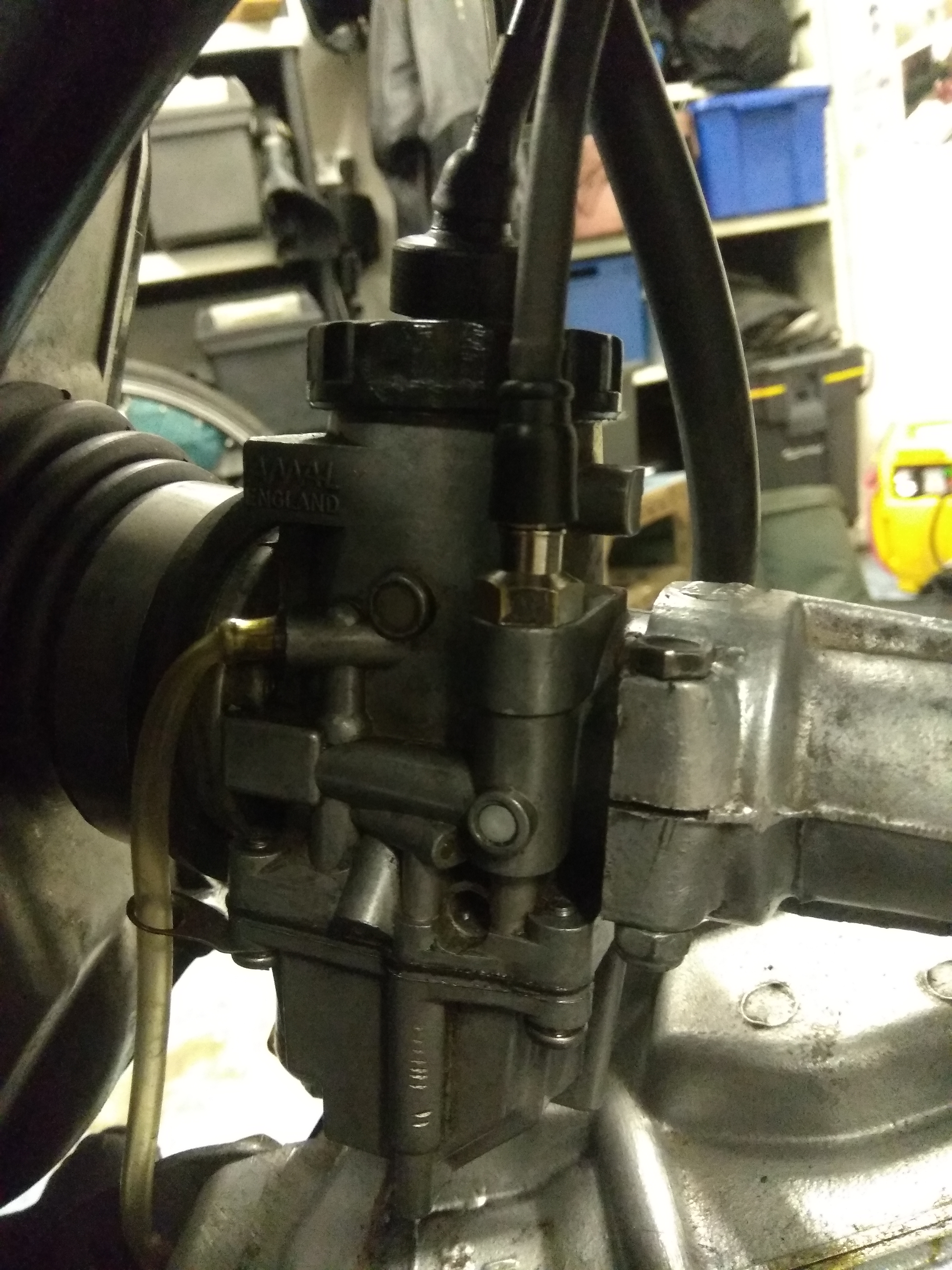

Postby DAVIDGUEST123 » Tue Nov 12, 2019 4:03 pm
My recently seized 250 is now back on the road and running ...sort of. The cold starting is a real pain but once warm runs fine, all be it with a little piston slap from the oversized rebore. I'm now looking into the carb. When I orginally bought the bike it came fitted with a Amal Concentric Mk2 carb and after a bit of digging the carbs mainjet had been drilled and float sticks. Another issue is the brass 'spray' is a four stroke one. I have tried the setting from the 'Sweller' carb web page but nothing seems to work.
I'm now a great beliver in standard is best, so I'm weighing up the options for a replacement carb. The options seem to be..
1) BVF Orginal ... If you know any about let me know
2) BVF non orginal copy cheap but are they any good?
3) Mukuni vm34 Seems to be difficult to get the rights jets without ordering fron the states
4) Change the spray tube in the amal...how's it done?
Any input greatfully taken on board
Thanks Dave

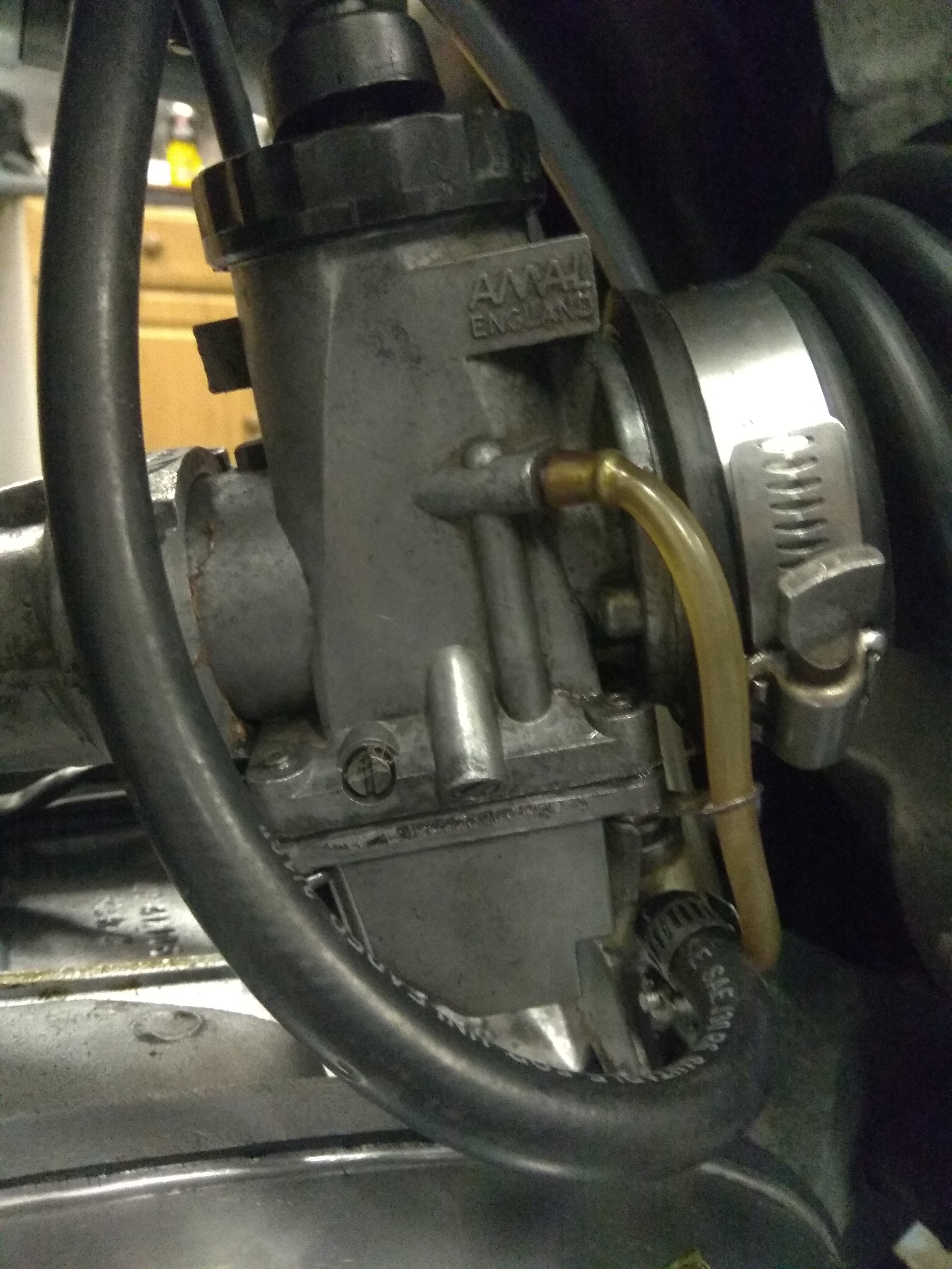

From the pics, your carb appears to be a MK II carb, either 2000 or otherwise. See for instance http://amalcarb.co.uk/generic-2000-series-mk11.html, and looking at the component list, apparently what was called 'spray tube' or 'needle guide' in my previous post, in Amal speak that's called: 'Needle Jet', item #15. It is screwed in #16, the Jet Holder. A whole variety of needle jets can be bought, for alcohol, 2T & 4T (which might be different in length). For the needle, #6, there will be a difference both in OD & in taper, depending on application.
The confusing Amal naming would suggest Sweller recommends a 2928/303, a Mark 2 series with a 28mm bore, left hand adjustment, 2 stoke petrol with spigot mounting. In the pics, I do not see numbers on your carb, but you can easily measure the venturi size with a calliper, and it does seem to be a Mark 2 series. But watch out: the jetting very much depends on the venturi size. A smaller venturi will cause higher flow velocities, necessitating smaller jets to make the same concentration fuel/air mixture (though less of it, in terms of volume). So before you order, check the venturi size.
The other thing is: why would Sweller recommend a carb smaller than the standard? The standard is 30mm, and you have that 2930, so that would be another possibility (presuming it fits in your manifold), and actually be my preference as it has the same venturi size as the original.
But indeed: jetting for that 30mm carb should be bigger than in the Sweller recommendation for the 28mm, and for the 32mm one you have now (?) it should be yet again richer. But I do not know by how much; maybe Sweller could advise for the 30mm carb?

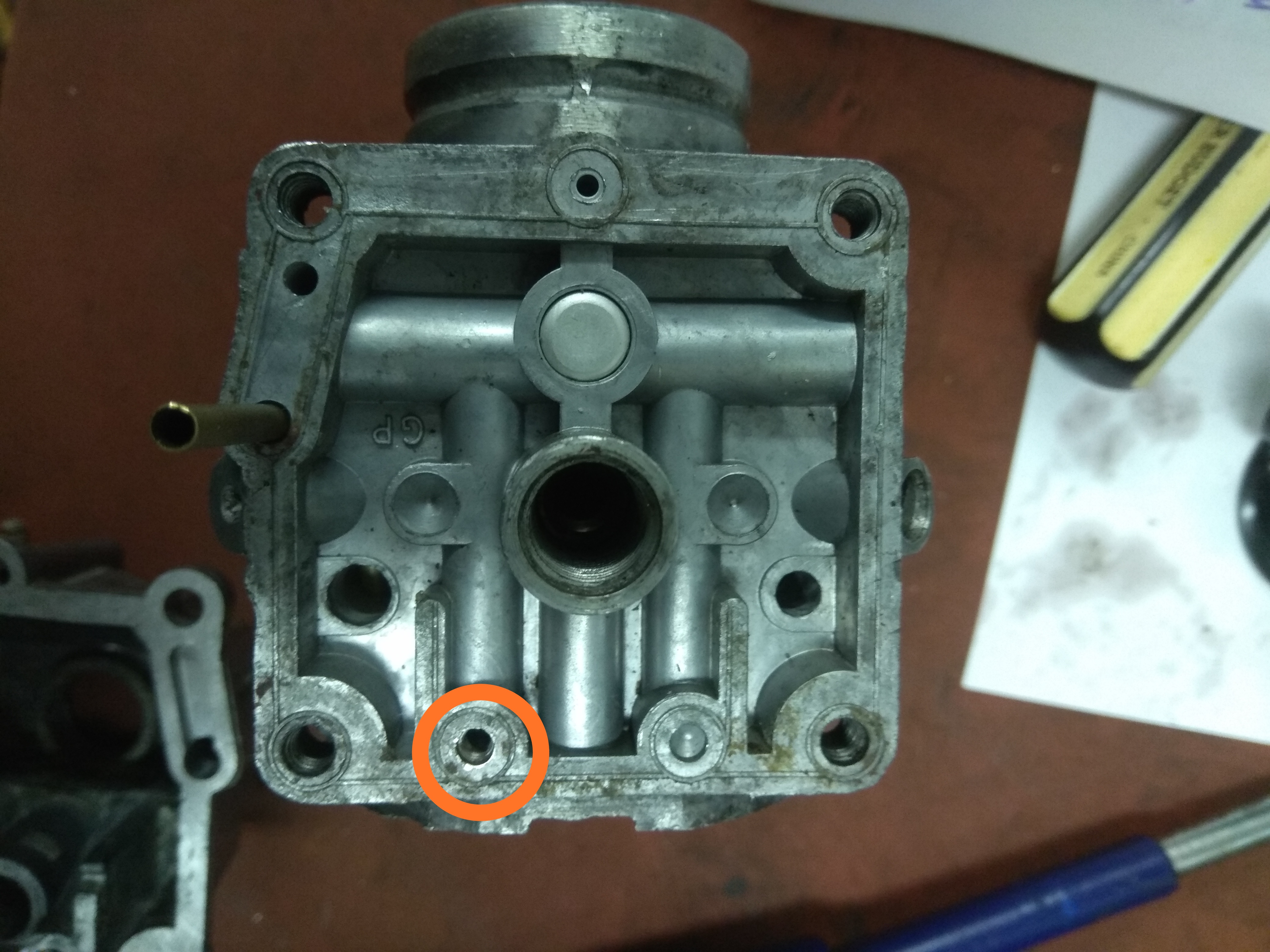

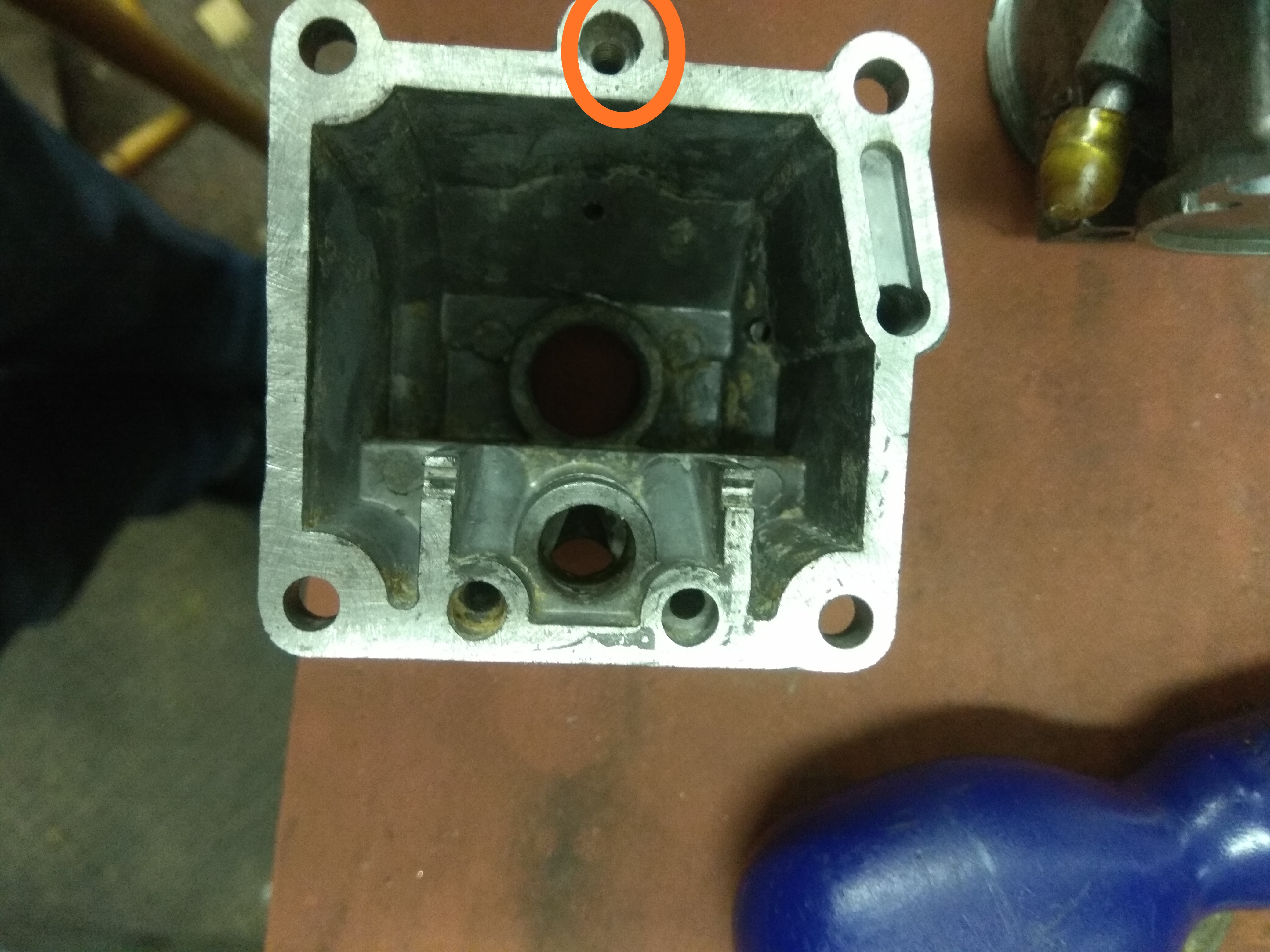

Well after a day of fiddling I found the answer. It may be of interest to anyone else think of going down the same route. The carb I have installed is
a 2930-303 with a Norton type Needle 'Spray tube. I managed to dig out from the bits that came with the bike a small plastic container with variuos jets. On dismantling the
carb the main jet and the needle jet were more or less correct 220/ 160 this is where the fun starts. the difference between the two stroke version and the four are.
Spray tube
Hole in in the side of the needle jet.( from top to bottom it's..Spray tube thingy. Needle jet. jet holder then main jet)
Main jet holder collar
And finally Two positions for the idle jet to sit.
This is where the problem was with my carb. The previous owner had installed two pilot jets one in the main body and another in the bowl. The reason for the wto position
is so that if neede the jet can be placed nearer the venturi exit which would be required for a two stroke.
So the only part which is incorrect now is the 'Spray thingy' and see that the bike now starts on the first kick and appears to run ok I may well leave alone.
When the weather improve here I'll give it a decent run and fine tune it.
Thanks Again Dave
Carb bowl with the two stroke pilot jet position.
Main body of the carb with the four stroke pilot jet position. this should be blocked with a small ally screw.
Main jet holder. The one without the collar is the two stroke type.

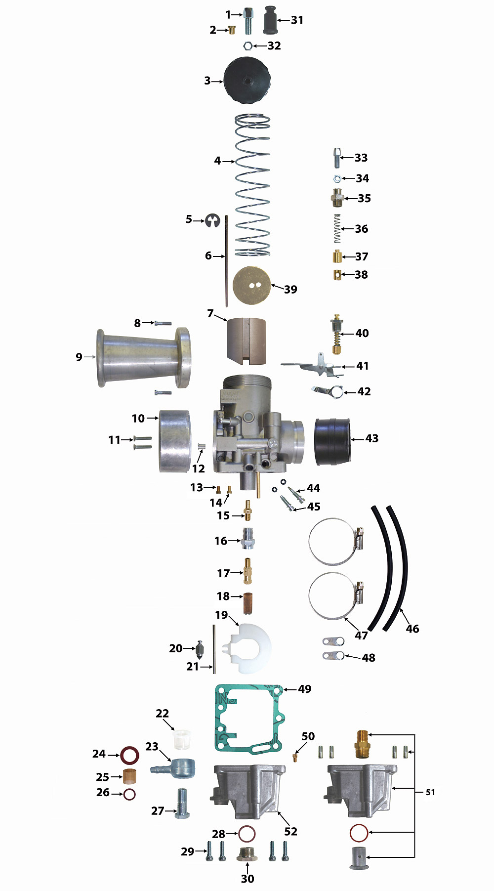

- The 2930 seems like the right carb for this bike. Following the Amal naming, the 303 has "left hand adjustment" (and the 302 RH), would you know what this "left hand adjustment" means?
- Following the Sweller recommendation of a 210 MJ in a 28mm carb, and presuming the number is proportional to the size, I'd expect a 225 in a 30mm carb. So 220 is indeed not far off, but might be a bit on the lean side. However, looking at the Amal site, those jet numbers do not seem proportional to size, and 225 does not exist... Anyway, regardless of all that, have a close look at your plug. Right after a good full speed blast, weather permitting, and also how the take-up is, near full throttle.
- Other manufacturers indicate their jet sizes in hundredths of mm, for instance my 250cc ETZ has standard a 130 main jet (I run a 133), indicating 1.30mm. Looking at the jet sizes on their site, Amal does not seem to do something as simple & understandable as that.
- Needle jet = needle guide = spray tube = 160 does not seem to exist, maybe it is 106? Anyway, here the number means something quite different, as the hole in this item should be bigger than in the main jet below it.
- I see, yes - ta. Indeed, on the Amal site the 4T needle jets seem to have a small hole, which the 2T ones don't show. Don't quite know what that would do, but it might make the mixture slightly leaner? Odd. It would seem to upset the venturi effect.
- Yes, I now see they indeed indicate 2 pilot jets, one placed at the air filter side (#50), and one on the side of the barrel (#13). On the website they don't give any guidance, but it makes sense to only install 1, I guess, and they also provide a 'jet blanking screw' (#14).
- On the jet holder (#16): they only indicate a single model on their site, only the one on the right, with the collar, which you suggest is for 4T. Could someone have filed off the collar? I don't see what the collar would do anyway.
Good luck with tuning your carb!
Posts: 2013
Re: TS 250/1 amal concentric
Postby DAVID THOMPSON » Tue Nov 19, 2019 8:54 am
i find carbs and hydraulic to be a bit of a problem they are both a mystery and a help
and may GOD help you if you use the wrong part or turn the adjustments the wrong way
and i have been helping a friend with his mess in a car ...things have not improved
there is now a computer involved :smt006
Dave
Postby DAVIDGUEST123 » Tue Nov 19, 2019 2:01 pm
Hi. Here some answers, or at least what I found out
Amal mk L2932-303 Two stoke carb left handed which means the adjustment screws are on the left.Makes life easier for something like a twin to have left and right adjustment 'Sides'
Swellers Amal mk2 carb number don't make sense.
#13 Pilot jet 25 in the front position ie near the barrel for a two stroke. Apparently two stroke don't suck as sharply as four stroke
#50 Small blocking screw shuts the other hole off. One and a quarter turns out on the air screw.
#17 Main jet is a 220. the number is not a physical hole size but a flow rate.ml/minute or something like that. Might try a 225 if it wasn't so bloody cold out.
# 7Slide is a two stroke 2928
#6 Needle a 2d1 matched with above.
#15Nozzle jet . My mistake not a 160 but a 106. Again this is flow rate but with the needle in.
#16The main jet holder without the collar. They are shown on the website and is sometime to do with how deep the main jet is in the float bowl
#2 And last but not least the 'Spray nozzle thingymebob' This surround the nozzle jet and is there to spread the fuel. Two strokes have a relativly slow suck as compared to a four stoke
There are three type One slopeing cut two stroke another flat as per#2 and one with a stepped cut I think this the one I have and can't see it's going to make that much difference.
p.s #31 is for an alcohol 4t
Any how with the settings and the carb above bike starts first kick and ticks over at 1500 rev without problem.
Hopefully this is of use to anyone
