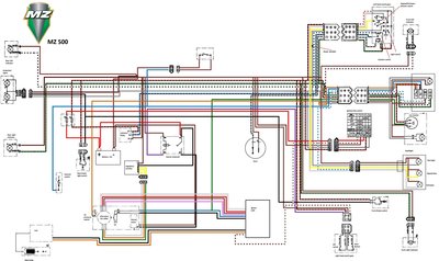

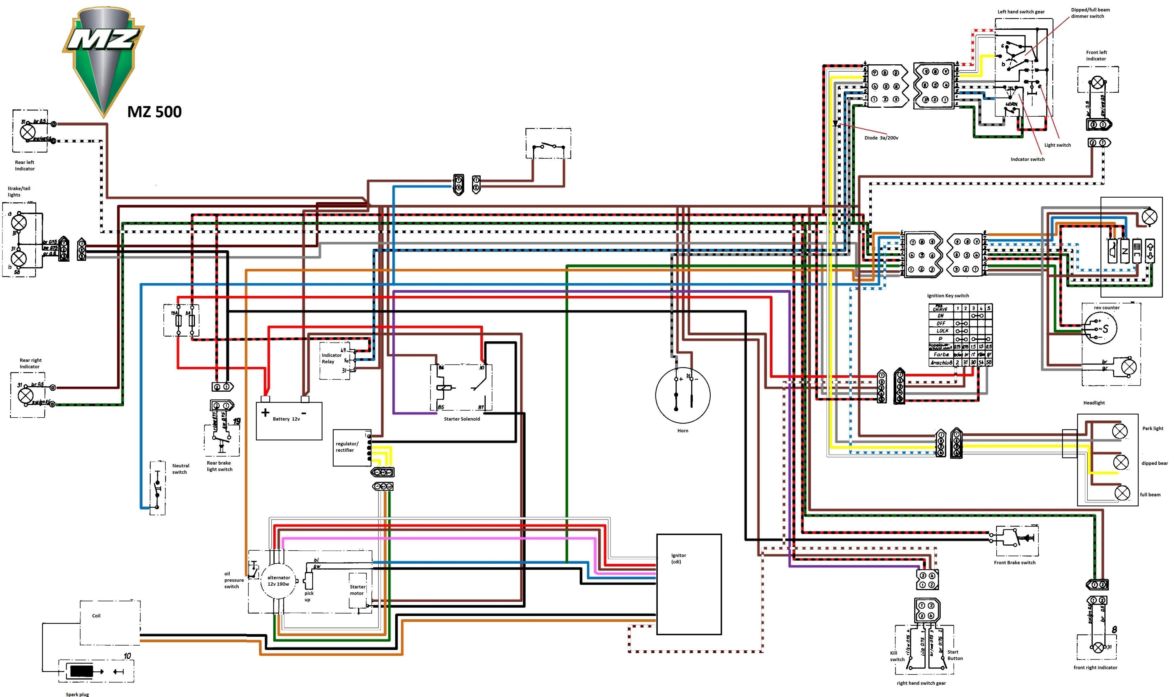

Postby TheFlyingPolak » Mon Jun 22, 2020 8:43 am
Thanks a lot for the suggestion nice2day!
Here you can see that the tachometer takes pulses directly from the ignition contact, which is located in the alternator.
Probing the + and - gives me about 0.45V less than battery voltage. Probing the signal gives -0.2V DC and the voltage does change when I rev the engine. Interestingly, the voltage is -0.08V when probed where the tacho signal wire (green) branches off from the ignition pulse wire (blue).
I'm guessing this means that the tacho is dead :D

Postby nice2day » Mon Jun 22, 2020 10:23 am
Thanks for showing the correct Circuit diagram which indeed is different from the older MZ ones.. . I was taking a guess with the circuit but was wrong. So yes, you are perfectly correct in that the Rev counter signal (green wire) DOES come from the ignition trigger in this model. The voltage variation is probably an effect caused by the way the meter reads the spiky AC signal. Most meters read RMS values (0.707 peak value of a sine wave) but because the ignition trigger spike is probably a square wave of sorts, it is causing some variation but this effect is not important anyway now. The best way would be to use an oscilloscope to see what the signal comprised of but not to worry. I would go back to the original suggestion of substitution or take a gamble and buy another one. Let us all know what you end up with. Best of luck....Les :)

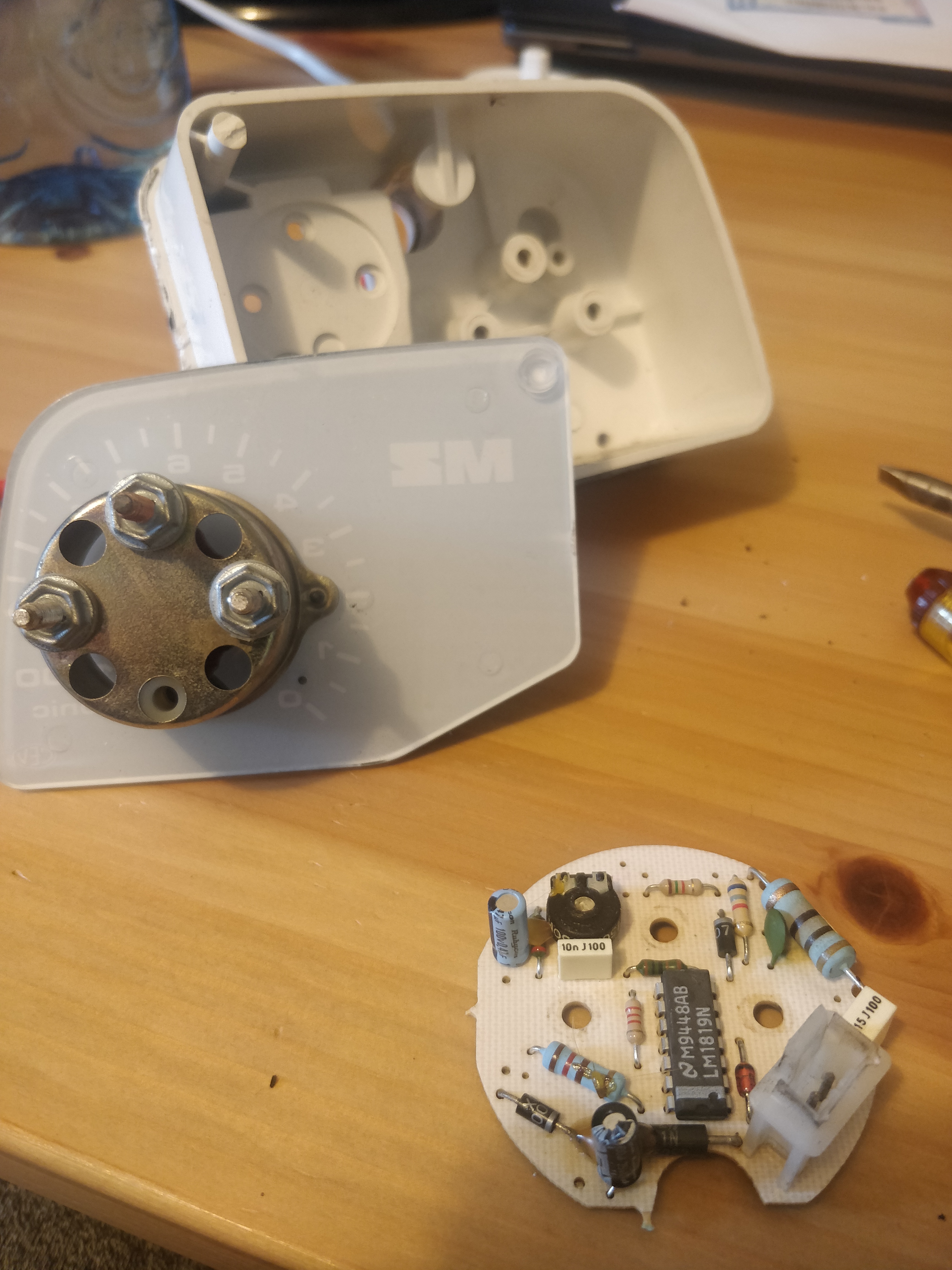

Postby TheFlyingPolak » Mon Jun 22, 2020 10:59 am
Update: I got inside the tachometer! Looks like there are multiple problems to find there.
Here's what the whole thing looks like on the inside:
The first problem I found was a resistor that somehow became de-soldered, so I re-soldered it and tested it. The needle now moves but there is another problem. When the ignition is turned on, the needle starts from slightly above 0 and slowly creeps upwards. When the engine is started, the needle never comes down until the ignition is turned off. Looks like whenever rpm increases, the needle rises but never falls when rpm drops. So by the time I start the engine from cold the tacho already makes almost a full revolution!
As to how to get inside the tachometer, the whole outer shroud is held in place with some sort of glue. It needs to be pried off all around, with plenty of force, and it will come off. The three brass screws at the back only hold the motor to the circuit board.

Postby nice2day » Mon Jun 22, 2020 2:00 pm
Well done. looks a very simple circuit. I would first replace the diode and zener diodes and the 2x electrolytic caps. Total about £5 and then if no change, replace the Lm1819n about another £5 (NB: This chip is obsolete and slightly hard to find a supplier apart from China via Ebay) and to make replacing the chip less risky, solder in a 14 pin dil socket so you can simply plug the new chip in. I reckon I would have a go if a replacement tacho was expensive... :wink:

Postby Blurredman » Tue Jun 23, 2020 2:10 am
That does look like an extremely simple bit of work, electronically..
You might not think it's worth re-flowing all joints first? If that doesn't work remove resistors one at a time and check? And also the diodes.. there isn't much there, so it's just a process of elimination - and it won't take long because the board is so small. :smt006

Postby Steve razor » Fri Jul 24, 2020 6:18 am
I recently had tacho problem. Resistor was unsoldered. Resoldered, still didn't work. Changed diode & all is OK now.. Diode was cheap ..there is a tacho\speedo combination on eBay for £25 plus postage from Florida (£28).. Would have done later if I couldn't have repaired it..cheers.p.s.mz was recent purchase ( barn find of 20yrs in garage).. Tank needed rust repairs, flow master internal coating, re spoke 2 wheels, repaint frame, swing arm, shocks & everything else, strip chrome from exhaust, handlebars, rack, replaced all cables, brake master & slave rebuild, new grips, new brake switch..list goes on and on,,,but I can see light at end of tunnel !!
