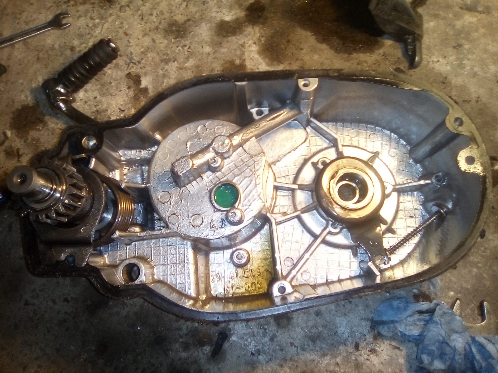

I also forgot to say. For anyone that was interested- this is the inside of the 'internal oil galley'.
You can see in this image below where the 'join' would be:
