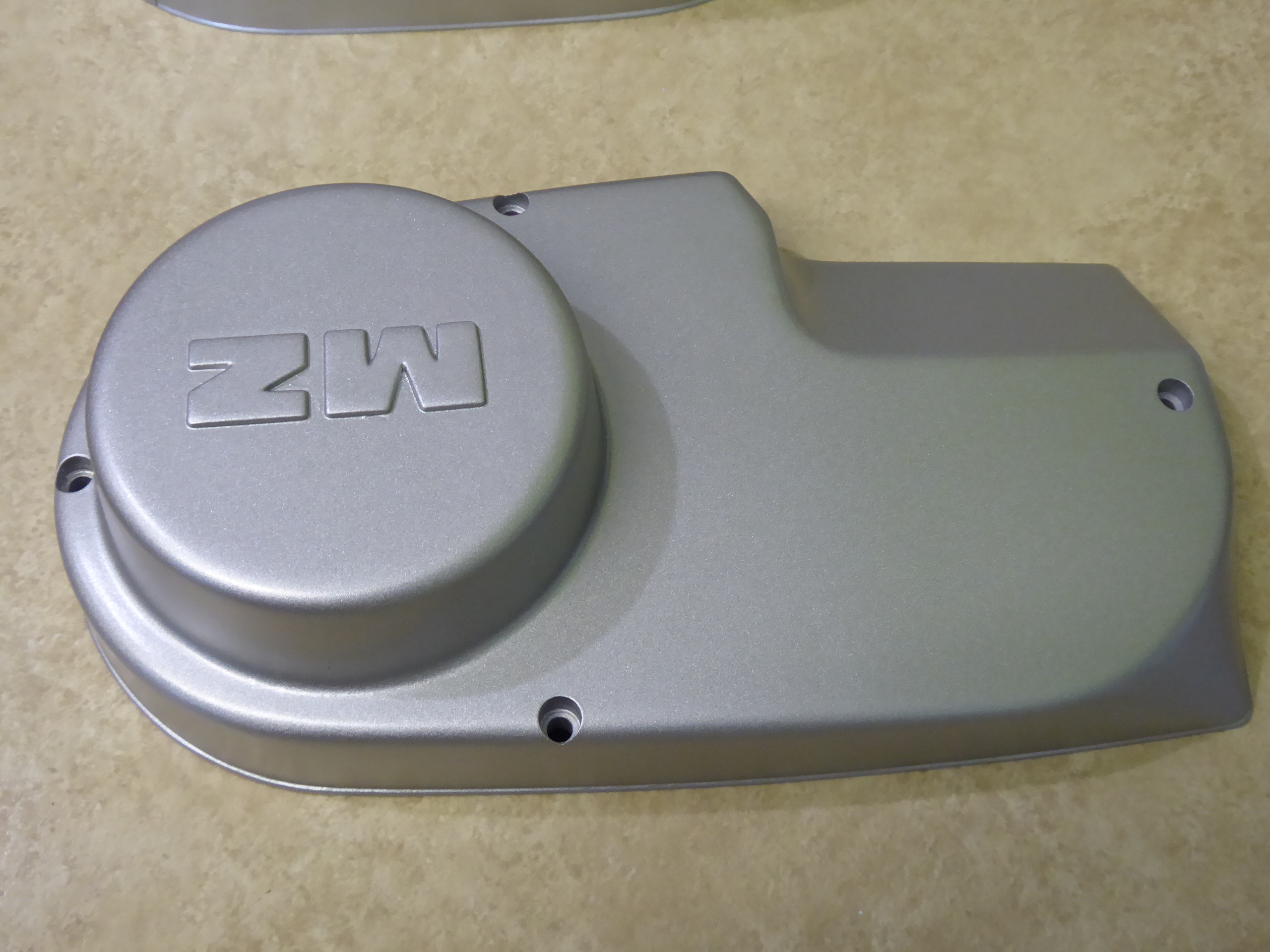

Postby nice2day » Wed Aug 26, 2020 5:18 pm

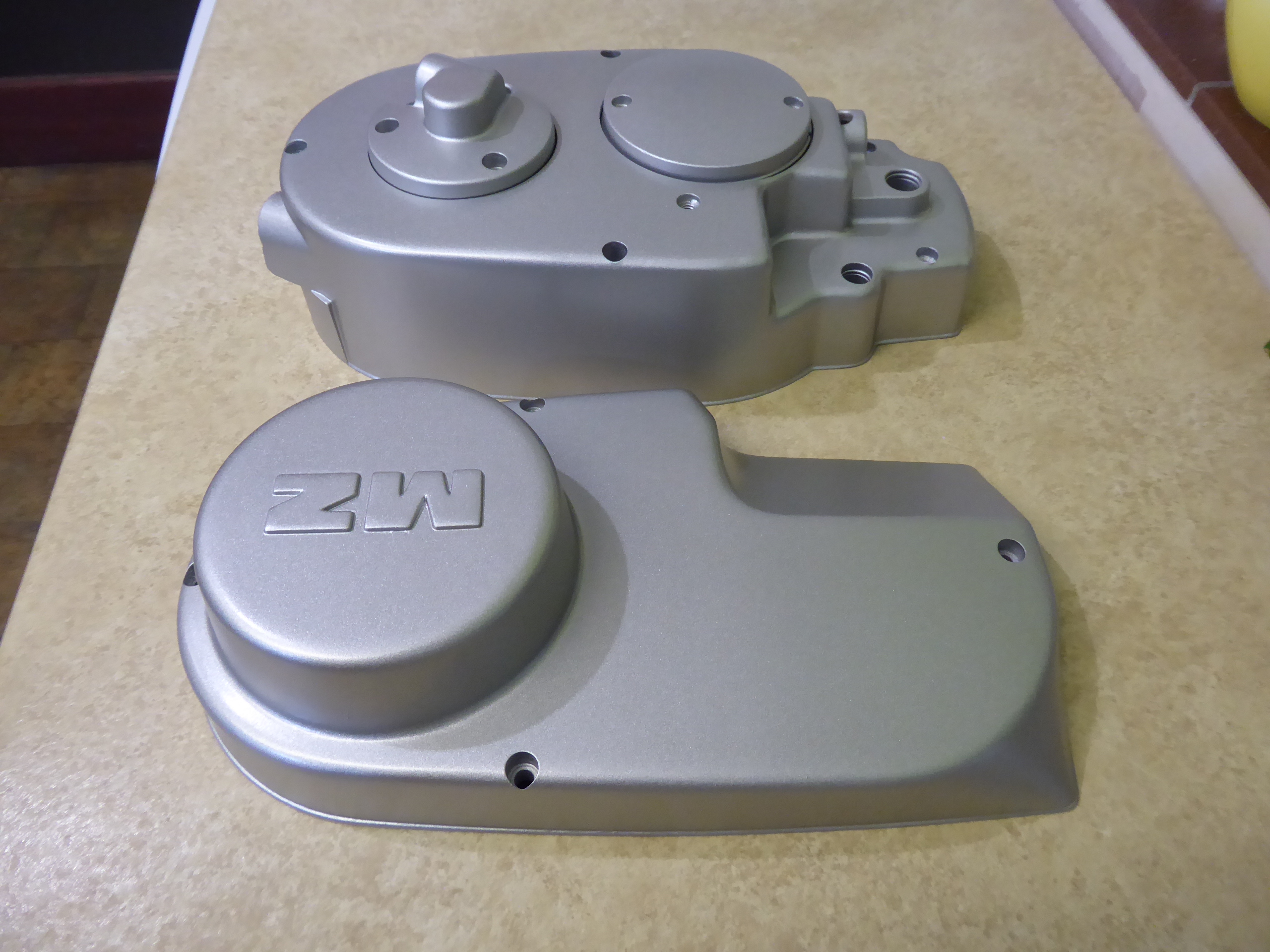

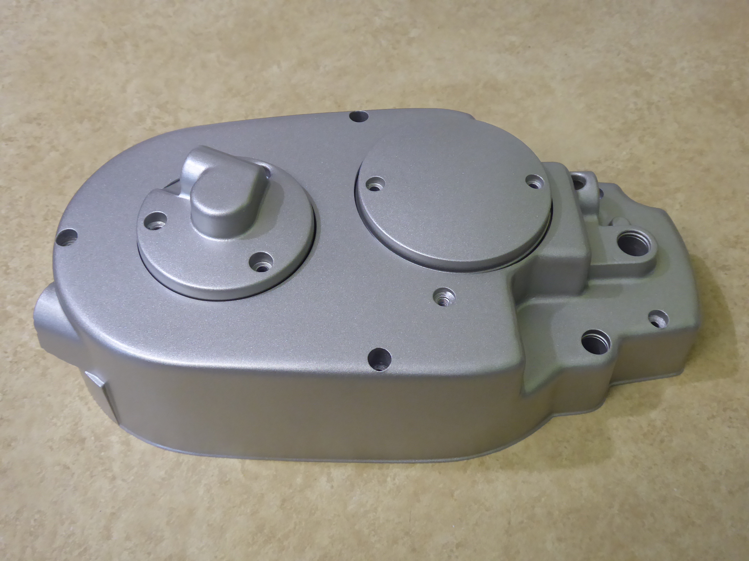

Just thought I'd show the cases I sprayed. Acid Etch Primed and then baked on ceramic engine enamel.
I'm quite pleased with the result.
Double click any photo to see the surface finish 8)

Postby nice2day » Thu Aug 27, 2020 5:44 am
Thanks Chaps...it actually looks more silver in real life. The paint was an aerosol VHT SP995 Engine Enamel. I have used literally hundreds of cans of spray paint over the years but this product is really excellent as it sprays particularly well with a steel pin spray nozzle which never drips or clogs and produces a very even spray. The real bonus is that you bake it at 100C for 20 minutes and it becomes very hard wearing. I am tempted to spray the tank and side boxes/panels with it too. My original choice would be to spray a base colour and finish with a 2K clear coat noting these GENUINE 2K finishes are available in a single aerosol tin nowadays. You do have to use a mask and body protection as the contents contain a cyanide based compound but you won't get a tougher glossier finish anywhere...after buffing down that is....Les

Postby nice2day » Thu Aug 27, 2020 6:41 am
Hi Blurredman...just to confirm that the ETZ engine covers were always painted and usually silver. Nowadays many ETZ covers are painted silk black just out of preference by the owner but it was not original as far as I am aware. Usually I am a fan of bright polished aluminium ** but somehow it does not look that good (IMO) on MZ's...plus you have to keep polishing them or they go very dull or corrode. Many of the later MZ's had the black covers but there was a problem with the paint blistering underneath as aluminium is never that easy to get paint to stick too which is why I used an acid etch primer or simply brush the surface with phosphoric acid and leave for a few minutes and dry with a towel and hot air...never wash the acid off as the phosphoric coat washes away with it, unless it dries first then it's fairly tough.
By the way I have an excellent example to show here how a phosphoric finish resists normal rusting so well....maybe I'll do it as a new topic...
Les

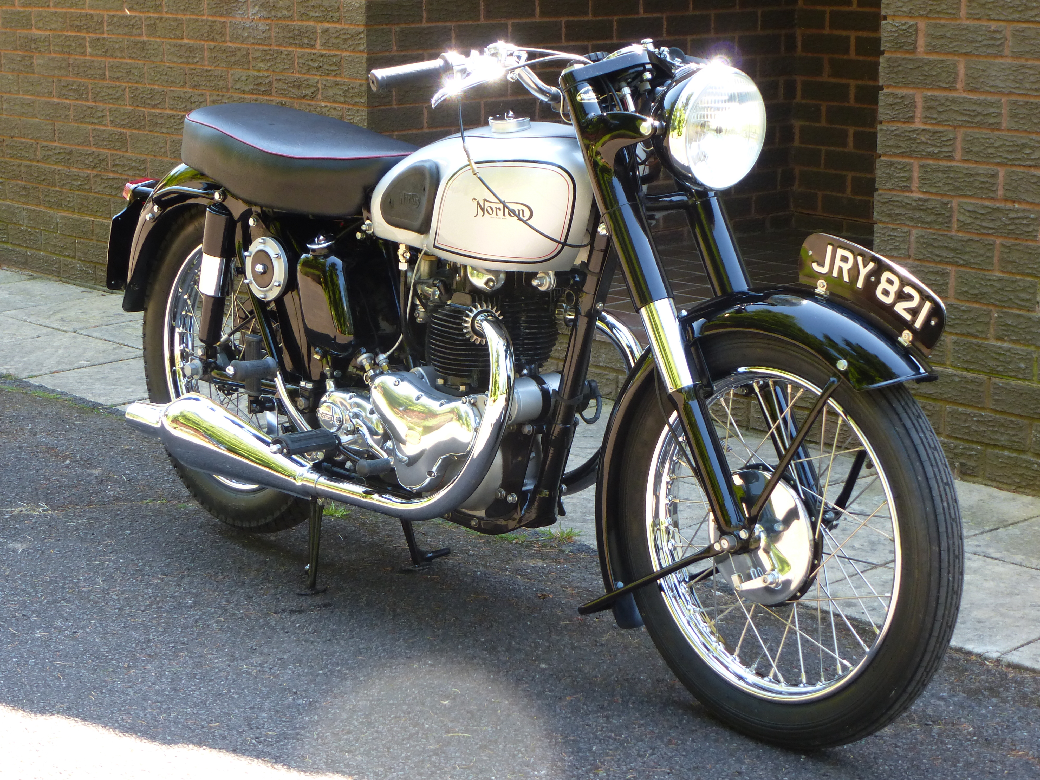

Nice Norton... Part of me still craves for a classic Brit bike - maybe once.
Posts: 2013
Re: Engine Cover Respray

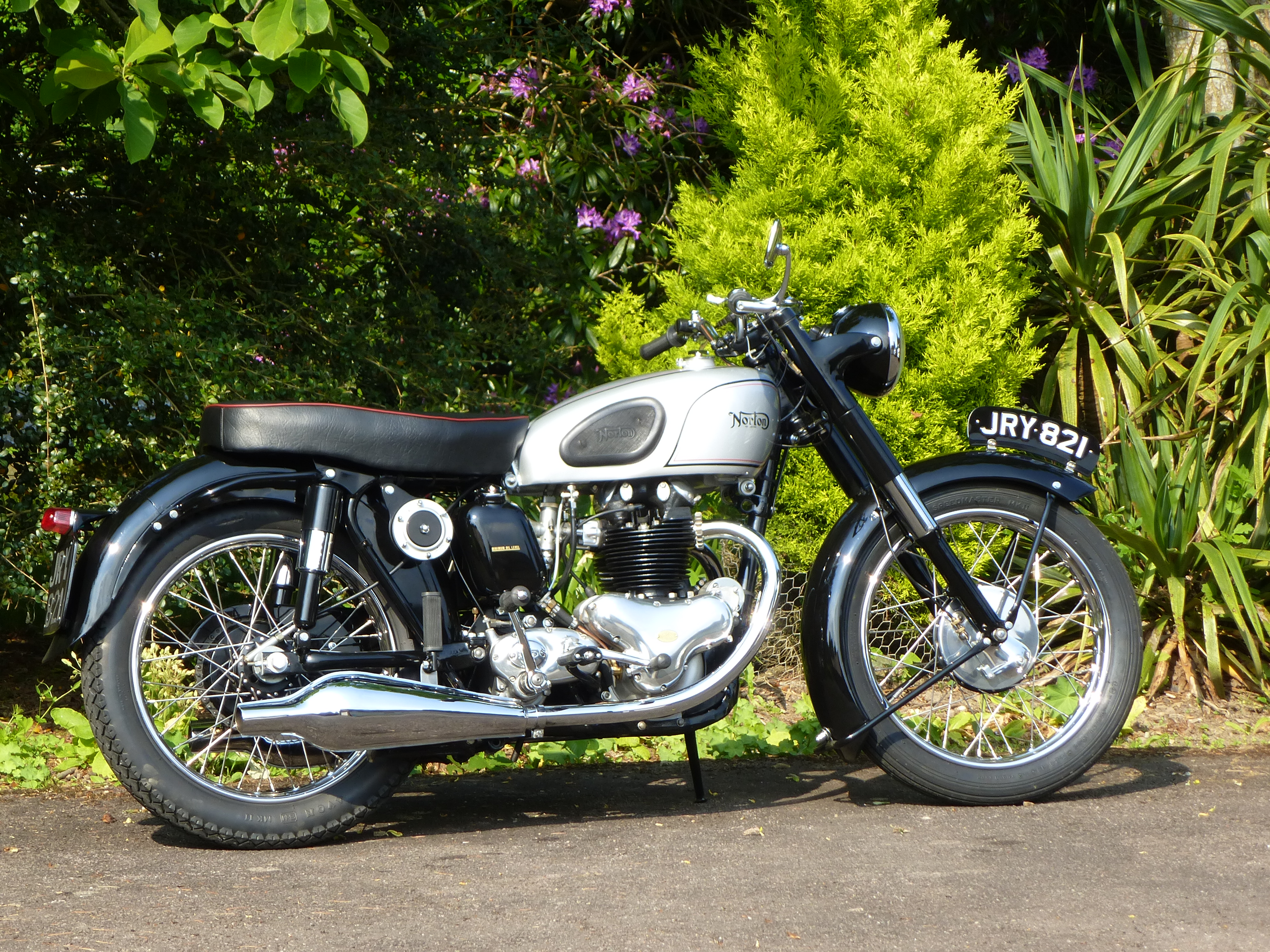

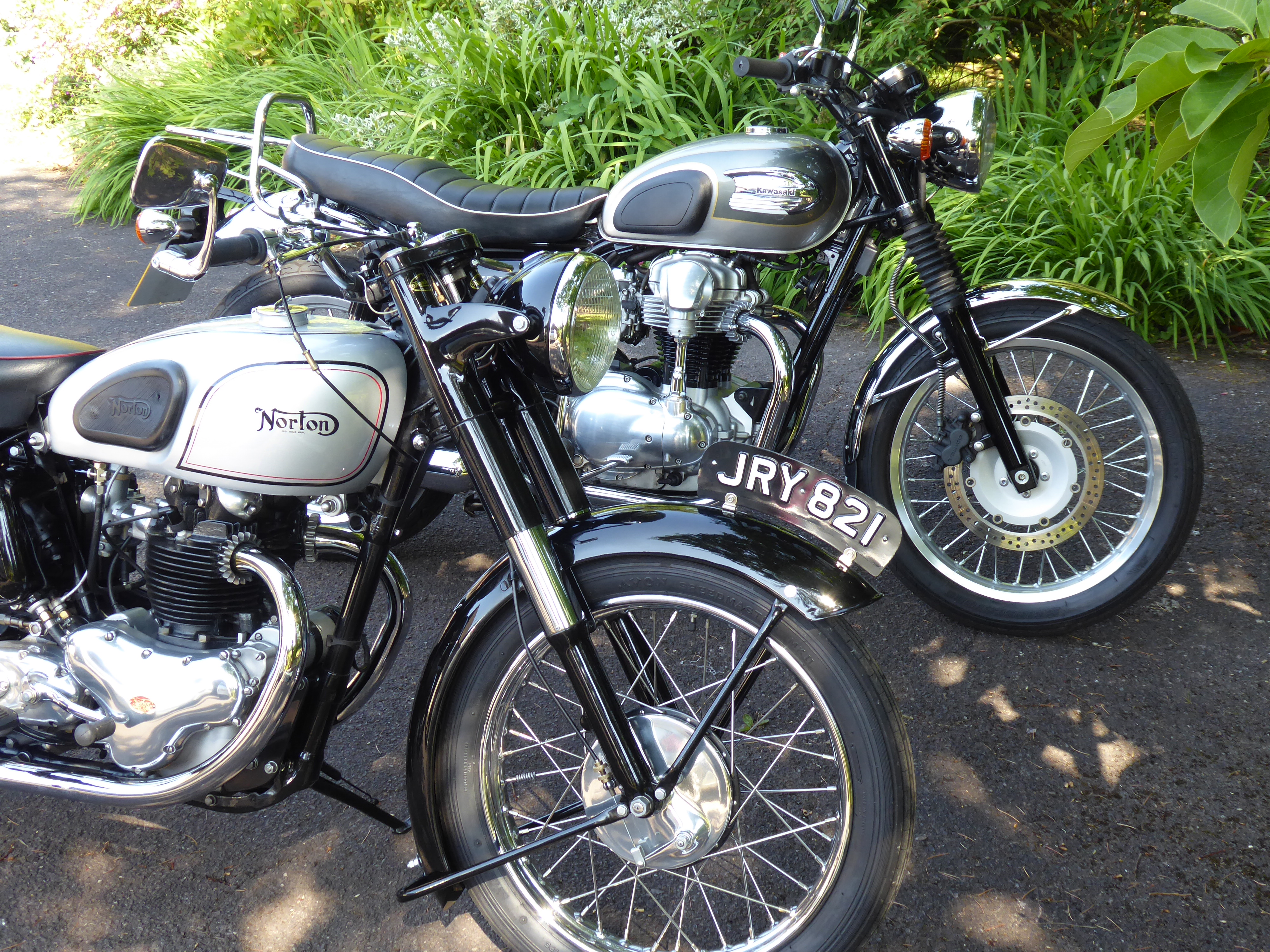

Postby nice2day » Sat Aug 29, 2020 7:24 am
Hi Puffs....Just the once....and maybe never again.... :lol: :lol: :lol: . I can understand!

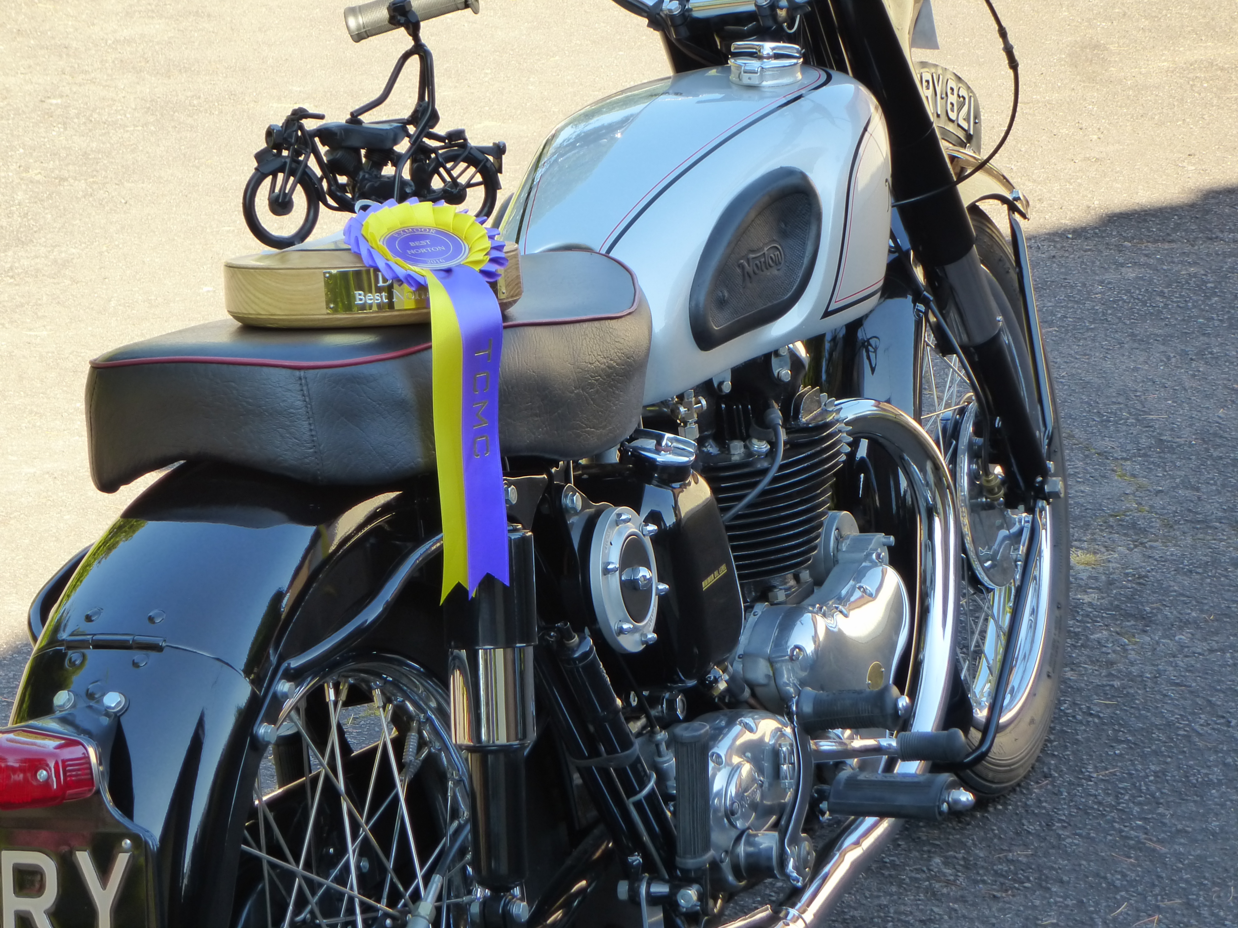

Yes the Norton is my favourite I suppose (Don't tell the other ones :lol: ) It was just a pile of corroded metal and it took me a period of 6 years to restore.
Most of it is original apart from the slightly oversize "peardrop" silencers which are a slightly poor copy but I had no choice, however the sound of the bike is awesome.
It gives me a great deal of pleasure rescuing something that was wreck and is now nearly 70 years. It's a wonderful feeling being carried along by such a living relic from the past. I love it.

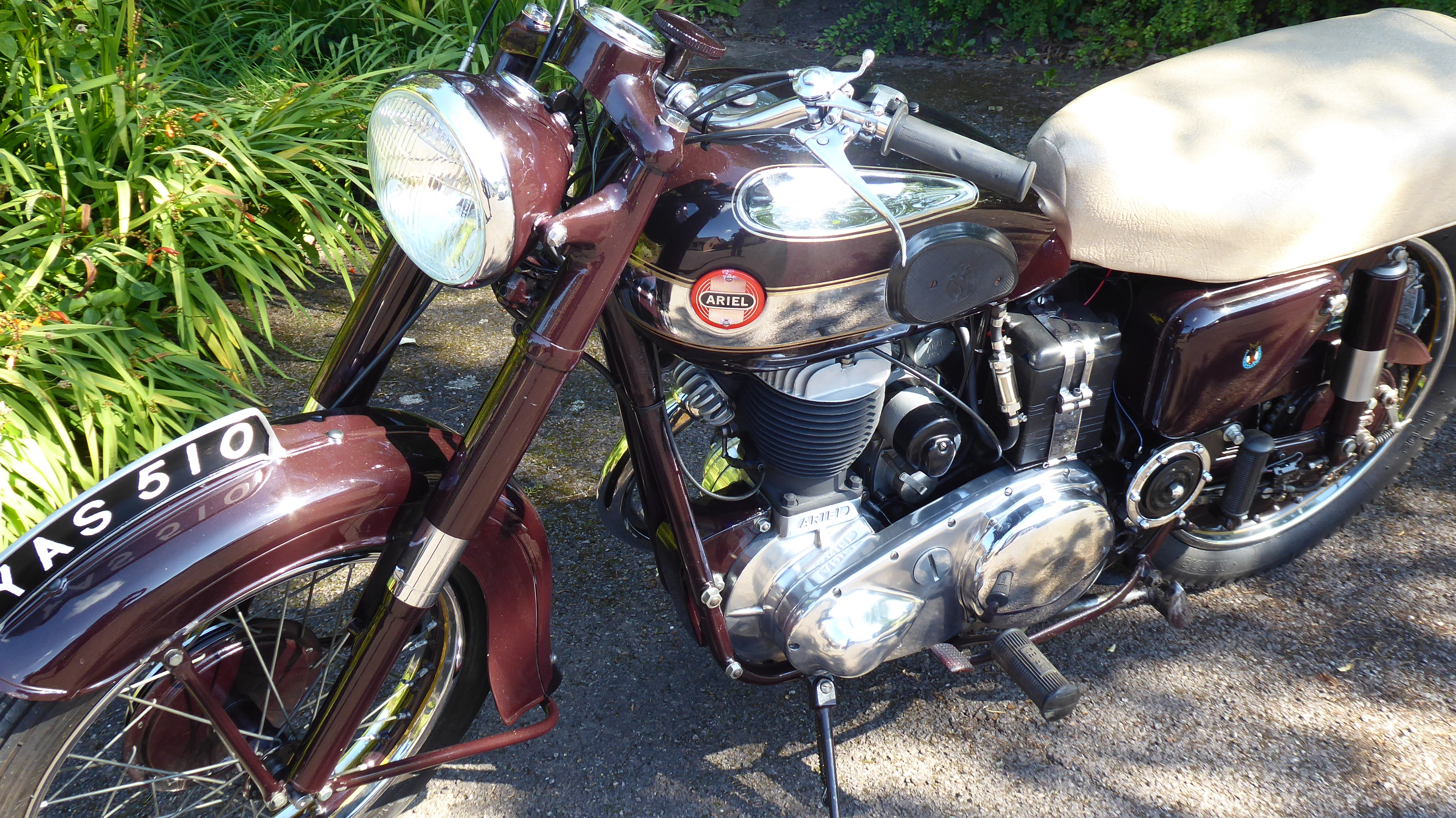

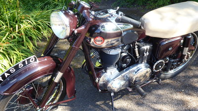

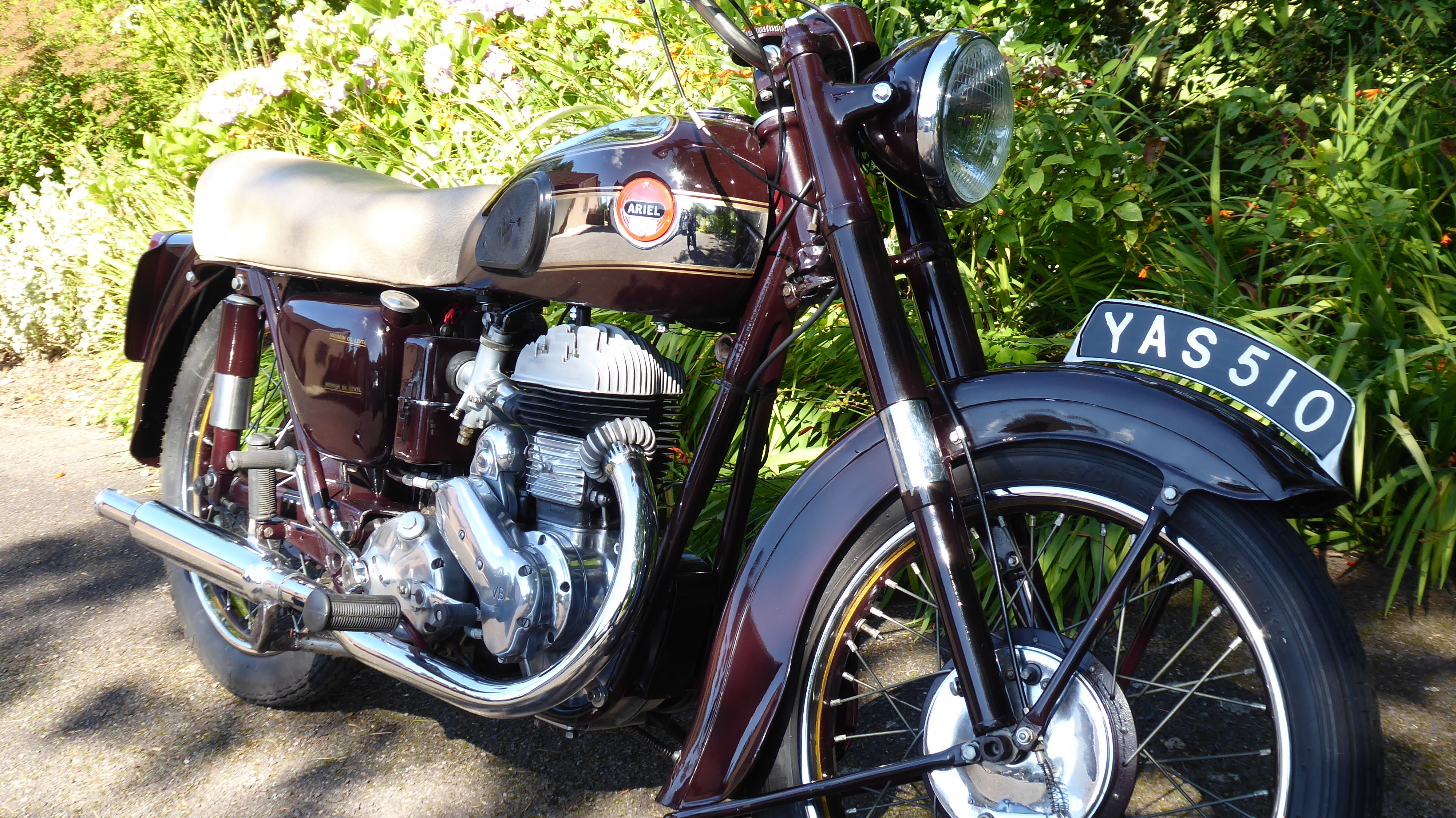

Thanks Puffs that's kind. Perhaps the best British single is the Velocette Venom...I WILL get myself one ...I promise myself all the time, but some of the others MUST go.
Then again the bikes you mention might be somewhat temperamental especially having close ratio gears.

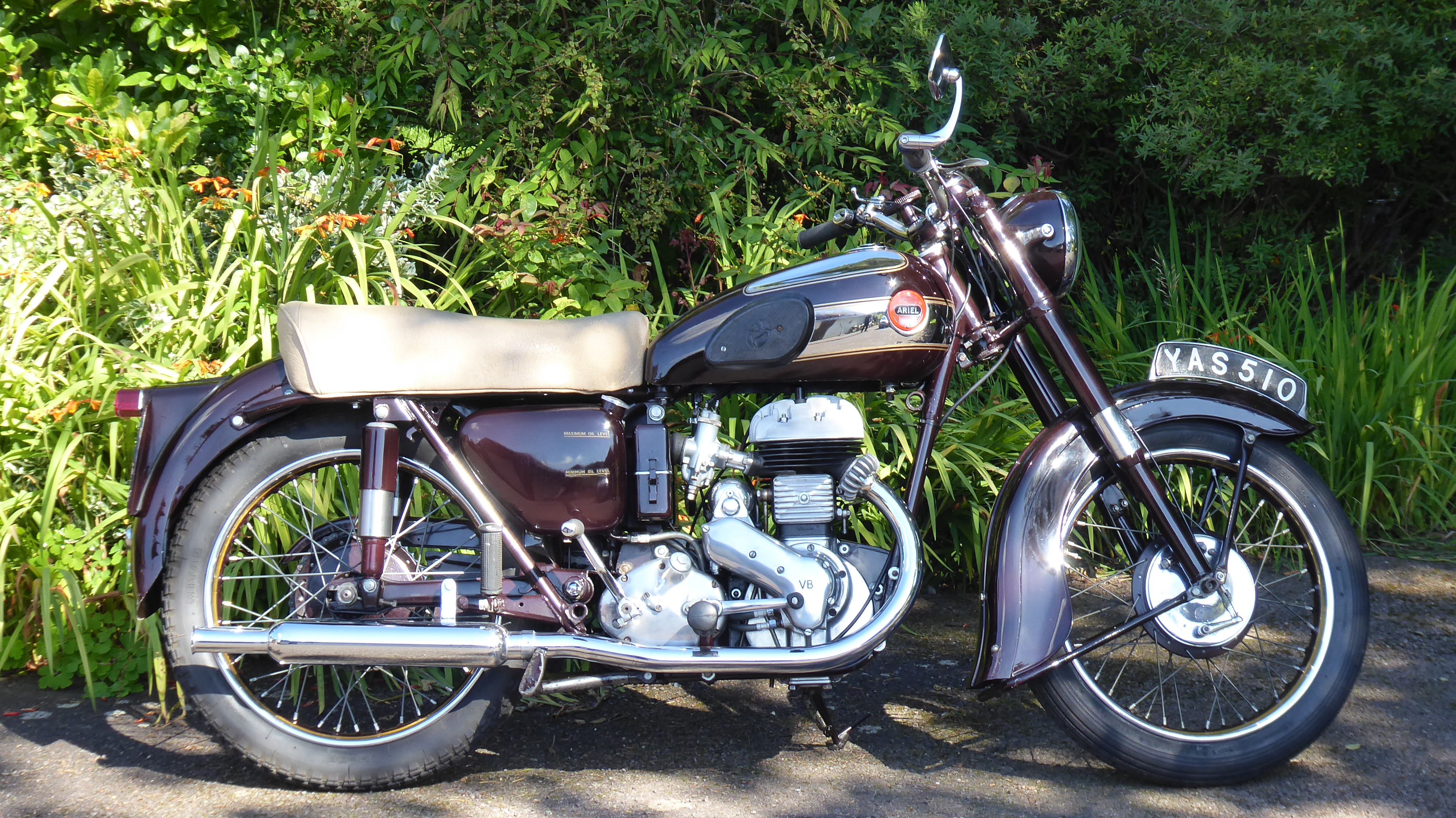

I suggest/ recommend you get a trusty big side-valve single like the BSA M21 or, as I've got, an Ariel VB 600. The low down grunty urge of that long stroke, low compression piston with its big 600 cc capacity is a wonderful feeling, perhaps like a horse lurching forward. They don't need high revs and they have less BHP and less speed than the wonderful MZ 250's but the feeling they give out is addictive. They lurch away from a standstill and "dig-in" on steep hills, free from the shackles of lugging around a huge side-car for which they were mostly bought for. When I ride it, it's like an old cart horse released from its daily burden and romping free in a beautiful grassy paddock and saying weeeeee!...lets have fun I feel wonderful today and it makes me feel the same, every mile of the journey :lol: :lol: :lol:
