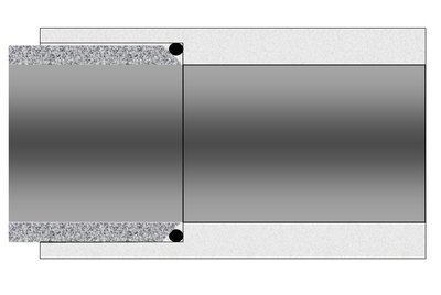

Just before I turned the computer off another idea came into my mind. :smt004
If you wanted to pursue the O ring idea rather than a washer, here is a safe way of implementing it.
Choose an O ring with a thickness of about 3mm and an Outside Diameter of exactly the manifold tube diameter at the lip position.
Then carefully file a 2mm chamfer at around 45 degrees all the way round the edge of the stub of the carb. When pushed all the way up to the O ring, the 45 Deg chamfer would hold the O ring securely in place and at the same time squash it and seal perfectly at the perimeter....perfect. :D :D :D

to me those eBay silicone washers seem nice, simple & effective, while filing your carb stub seems less attractive. But all those approaches rely on the carb stub retaining a forward push into the manifold, which might not be the case over time.
To be sure that leaking there really is the issue, I'd just assemble the carb into the manifold with some silicone sealant.
Note that a leak there will only influence idling; once you open the throttle that makes for a much bigger hole and the ΔP across that joint reduces.

I think you would agree with me though that if the seal, whether it was a washer or an O ring, had quite a degree of "sponginess" or compressibility, the carb would not be likely to move that much to slacken the compression on the seal. In fact it is not likely to move hardly any amount in practice but yes, you still need the initial compression on the seal which makes the rubber O ring ideal but it does need retaining in a cavity of some sort. A rubber washer will also work but I don't know how "squidgy" the silicon one I recommended is so I take back that recommendation.
I agree that obtaining the bevel on the carb is a little tricky but not too difficult to get a decent shape I think. I would use a sheet of coarse wet-and- dry on a surface plate and swirl the end of the carb round and round with a wrist movement holding the carb at the 45 deg (approx) angle to get the bevel on the edge ....it's only soft aluminium and I reckon I could get it done in about 5 mins and it would be pretty even. It doesn't have to be that big, just a couple of millimetres wide :|

I'd rotate the carb on a belt sander, 45°, and it would work, but still... it rubs against the grain to mutilate an original BVF.
To each his own, but practically I don't remove the carb very often, and I don't think that blue silicone would be messy at all. If so desired, you can assemble carb & manifold on the bench (clean-up with your finger through the carb). Or adapt/make another manifold using a rubber muff (as Guesi showed & me too on the Chinco carb).
