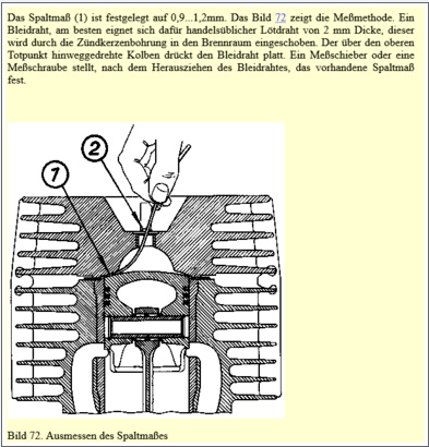

Mine is an ETZ251, yours is a TS251, I do not have the Haynes manual for yours, but you mentioning those squish numbers (1.4 to .1.6 mm) made me look it up in the original MZ manual, where I find:
That's the same 0.9 - 1.2mm as is mentioned for the 250cc ETZ's, maybe Haynes is in error here? The pic above pertains to the TS250/1, which is different from the 4-gear TS250. (Btw, you upload pics via the 'Upload attachment' tab at the bottom.)
I'm not sure head gaskets in 2.0mm thickness are sold, but you could make them yourself. A thickness of 0.2mm is common, and yes, if you need 0.4mm for the right squish, you can fit 2 on top of each other. There may also be 0.40mm thick gaskets, I don't know. I think 0.50mm is the thickest available.

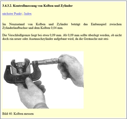

A piston should always be measured at the skirt. Because of thermal expansion, the crest always expands more in use, and is therefore a bit smaller (pistons are made to be tapered). Again the manual shows how to measure:
See the maximum clearance they specify for the TS250/1. For the ETZ this is increased to 0.10mm, and honestly, you could go a little higher IMO. But it is important to mention these clearances pertain to original pistons, Megu, HAL, KAL, in K20 alloy. Aftermarket pistons may need more clearance, but if it gets in excess of 0.15mm surely work is required.
I guess crown = crest, and I just measured an old Megu of mine, where the crest is about 0.13mm smaller than the skirt.
It seems you made a typo, or your piston has in excess of 1mm clearance??? The standard bore is 69mm, and 'no lip' is good.
