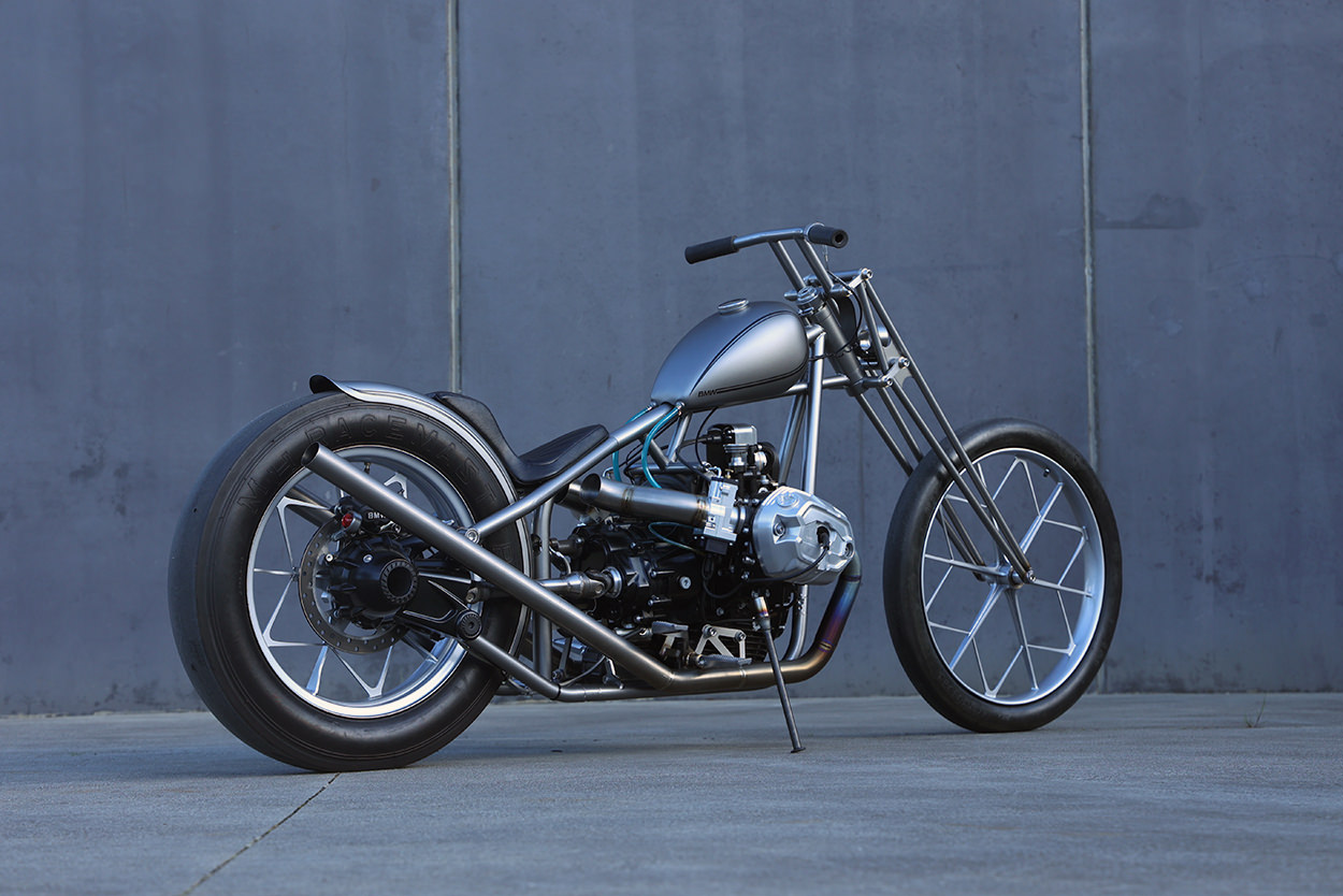

Like this? Ha ha. :D

Postby DAVID THOMPSON » Mon May 29, 2023 12:08 pm
the problem with most bmw choppers is they turn out real UGLY most of the time
the one above is better than most
