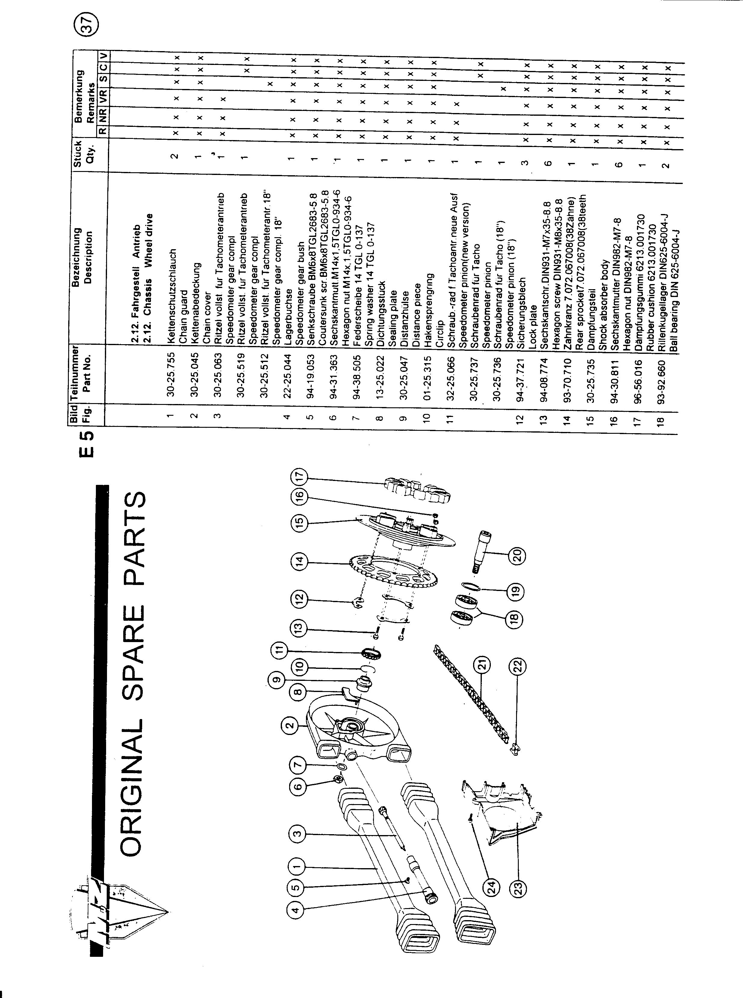

the parts book for you
item 17
9656016000 Sterndämpfungsgummi £19.26£22.15
still in the uk dealers price list but they may or may not have them
