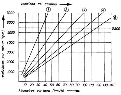

One circulates in the 2nd gear and wonder: when I change to 3rd or 4th? What are harmful rotational speed, or do what we are in an rpm ETZ 250/251, when it reached a speed of 50 km / h in 3rd speed?
Fig.1a. Graph relating km / h with rpm depending on which gear you are cruising.
Anyone who owns a machine with counter, one must read on the clock the number of rpm. Otherwise we will be guided, especially during filming, with the MZ velocity diagram (Fig. 1), to find out what speeds are reached at different speeds to approx. 4000 rpm. Not much more than the scheme of 4000 rpm is circulated during filming.
But back again to the speed chart for the ETZ 250/251 of Figure 1. 50 km / h in 3rd speed according to this assume 3500 rpm! A similar scheme is not a new engine destroys nowhere near!
Only in the interval from 5200 to 5400 rpm the maximum torque is reached (which is the more "pulling" the propeller) of this engine. The velocities corresponding to these regimes should be remembered, as we know, during the shooting and additional adverse conditions, which speed up our engine since it is easier.
In the case of the ETZ 250/251, this happens in 1st gear from the 32 km / h in the 2nd from the 53 km / h in the 3rd speed from 75 km / h in aa 4th from 95 km / h.
If the speed drops below these limits at different speeds to tackle a steep slope, or by a strong headwind, the engine starts to "pant" is "torture" itself. Under these conditions, even to the throttle and the speed increases under such conditions.
The engine can not transform the excessive air-fuel mixture that is offered, because the transmission ratio change is not adjusted to the resistance it finds. The engine can only develop its full strength when it is held between the rpm values for the maximum torque and maximum power. So down at the right speed!
