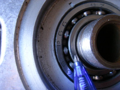

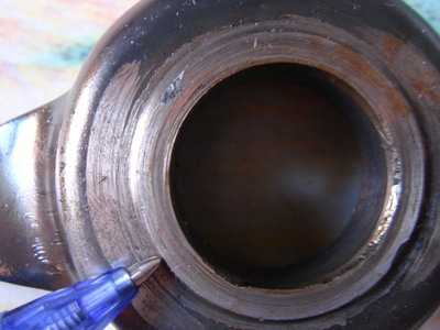

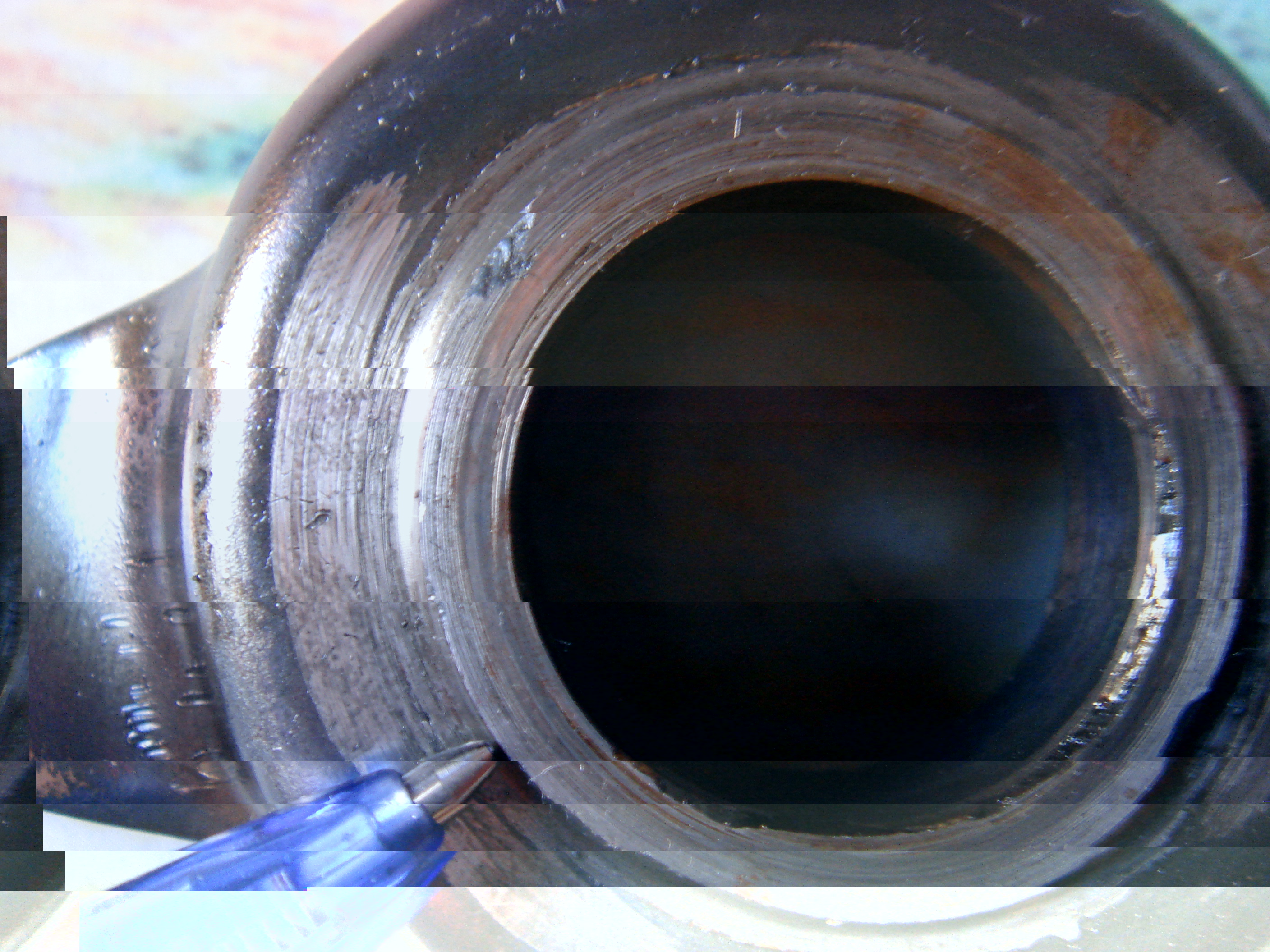

Postby manumensa » Wed Mar 10, 2010 7:06 pm
Hello
Some pictures:

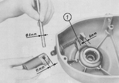

Postby NinthOption » Thu Mar 11, 2010 8:23 am
Thank you for the pics, they're spot on. The only difference is that on the TS250/1 the bit of the crank that comes through the center there tapers down a step to drive the tachometer.
The two spots you point to with the pen touch, and I assume their interaction is how the clutch is actually actuated. Do you know exact how this works. Is it simply by pressing on it? I couldn't push in the part on the clutch by hand, so I thought that was unlikely.
I have the manual the other pics are from, and I put things back together as close to those diagrams as possible, 6mm gap and all. Like I said, using the clutch adjuster plate and the hand adjuster I managed to get the clutch to feel right. Something definately moves under the cover. It just doesn't disengage when it does so.
Thanks again.

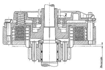

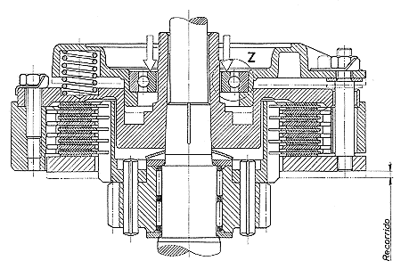

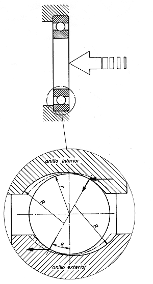

Postby manumensa » Sat Mar 13, 2010 6:17 pm
Hello,
We need more than breakfast "Corn Flakes" to can push in the part on the clutch by hand. :D
In the clutch 6 resorts like this picture works for the clutch discs don´t slip - engine power aprox. 20 hp-.
We can do it by simple machines: lever, screw "worm gear" (convert a rotational force to a linear force) the engine cover
screw for multiply the mechanic force that can be applied to cluth ballbearing.
In the picture axial forces on the clutch ballbearing 16005 , the "worm gear" pressing on it.
