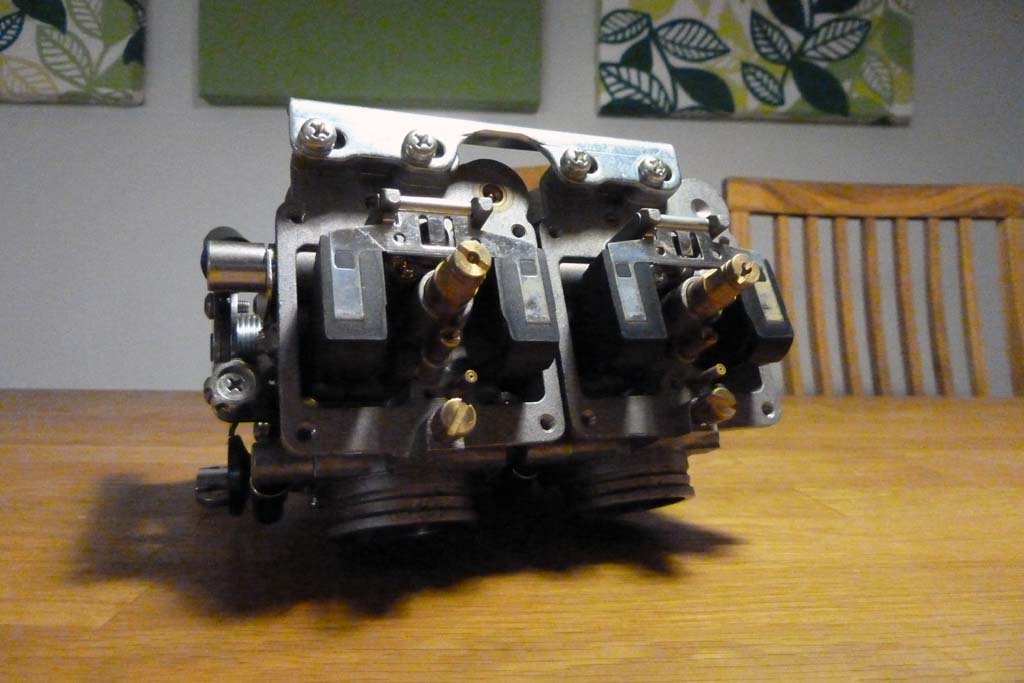

I have just bought a pair of Mikuni 34mm flatslides but they have not been set up and would love to know if anyone can help with the jets and needles recomended for my bike before i fit them.

I have a spare set of Mikuni flatslides (TM34-B65) set up for a stock XT/SRX600 that I havent had time to fit to my SRX yet. I can check jets and needles this weekend, it should give you a fairly good starting point at least. One thing comes to mind, you may need to adjust the acceleretor pump setting as well.

That would be a huge help thank you.....they actually arrived today and look better up close than in the picture. I bought them from ebay and paid £65, there not knew and came from a GSXR750, i hope there the right ones as they are Mikuni 34mm flatslides but i do not know if they are what you would call TM34-B65!

The TM34-B65 carb set is more or less a direct aftermarket replacment for the stock Tekei CV carb and a half.
See viewtopic.php?f=3&t=3536
Are the GSXR carbs all mechanical lift or CV assisted?
I believe both where used depending on year/model, if they are CV (vacuum lift) assisted you will not get the same crisp throttle response of a full mechanical lift but they should still be better and easier to tune than the stock Tekei.

They appear to be mechanical as both the slides operate smoothly from base to wide open via the throttle linkage.....phew! didn't realise there were cv ones aswell,

Mikuni TM34-B65 base set up for XT/SRX600, the 660 may need to go a little bigger on the main jet but its a god starting point
Main jet: #105
Secondary: #20
Needle: Middle position
Mixture 1-1.5 turns out
