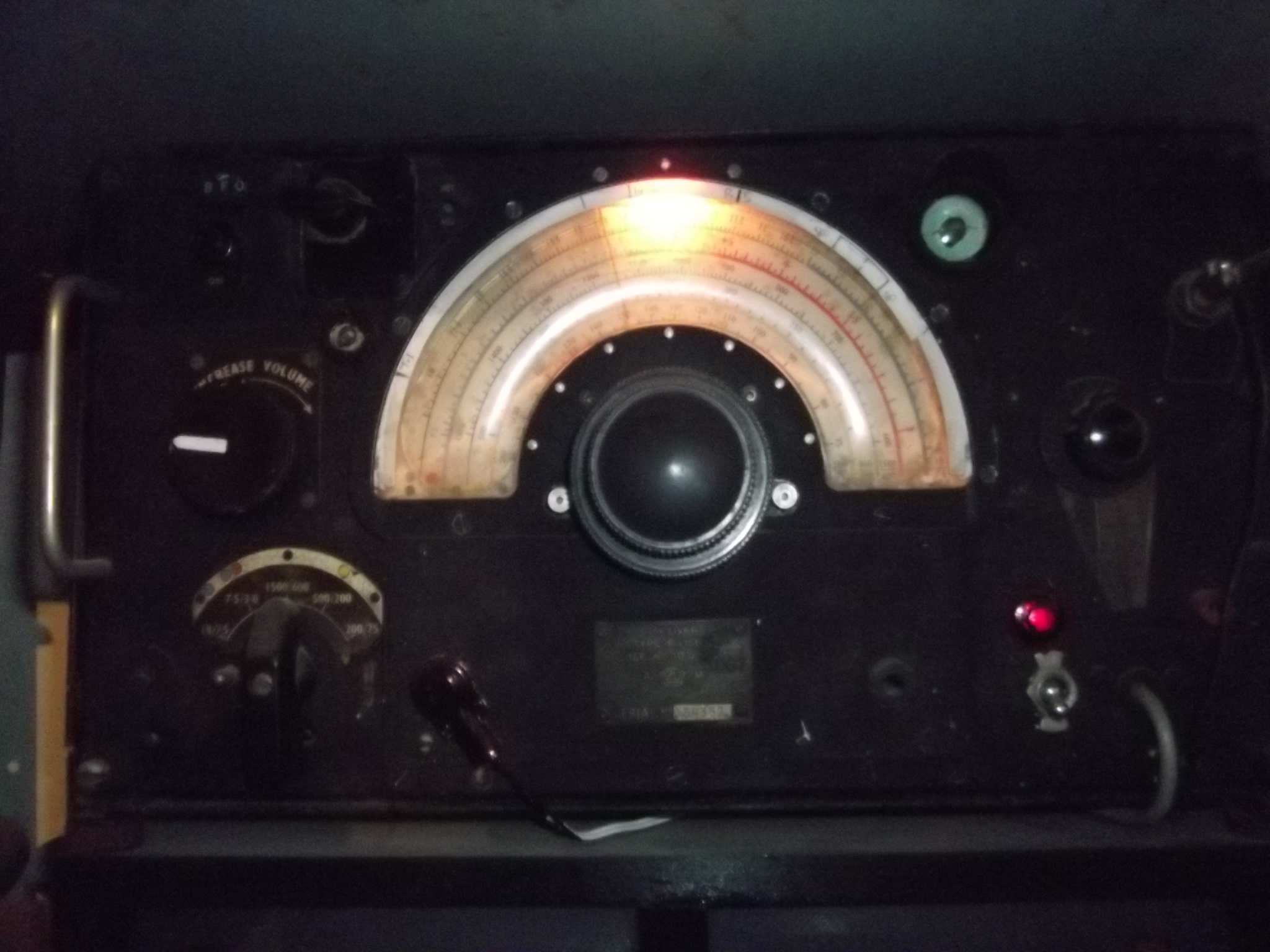

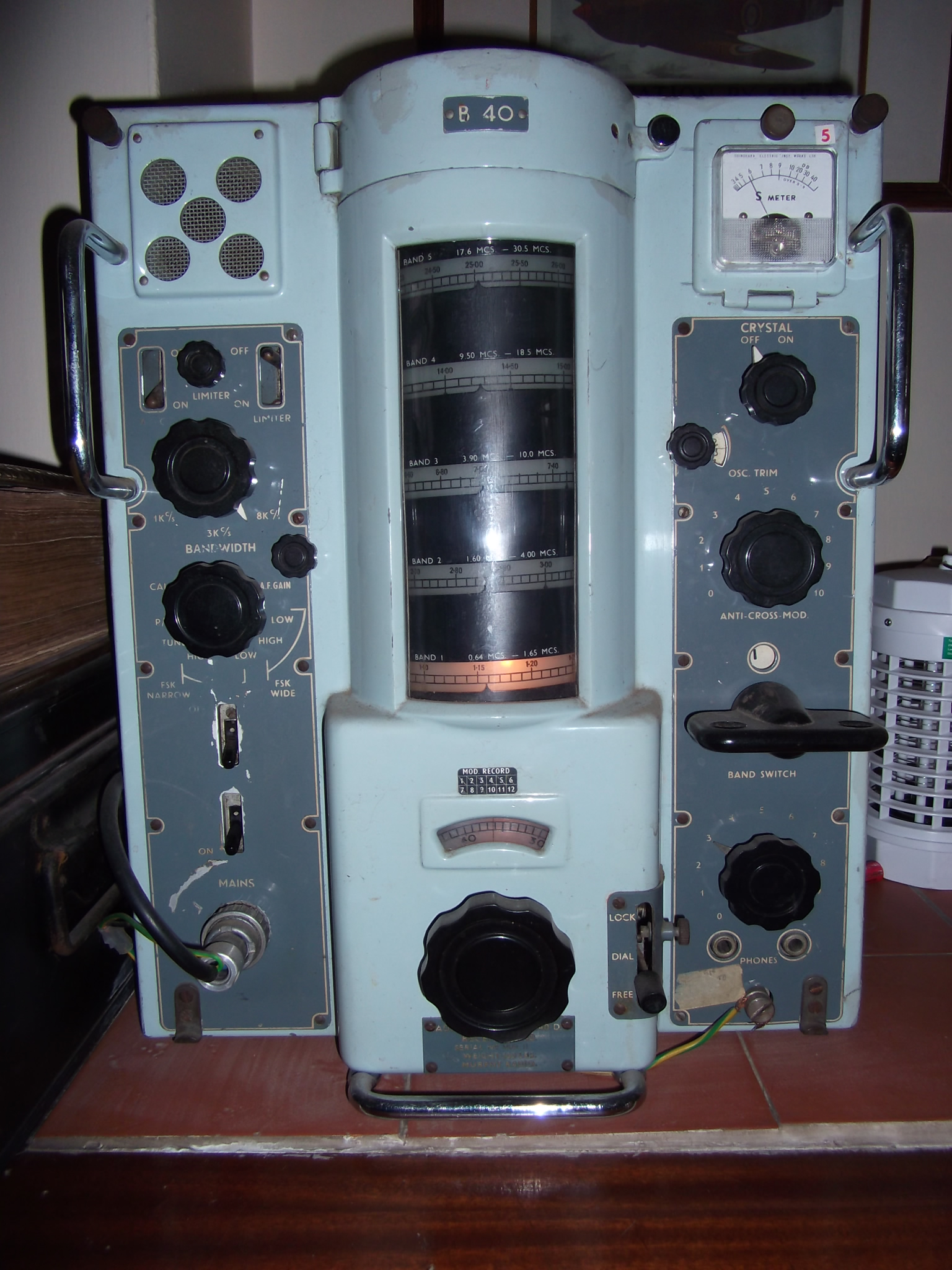

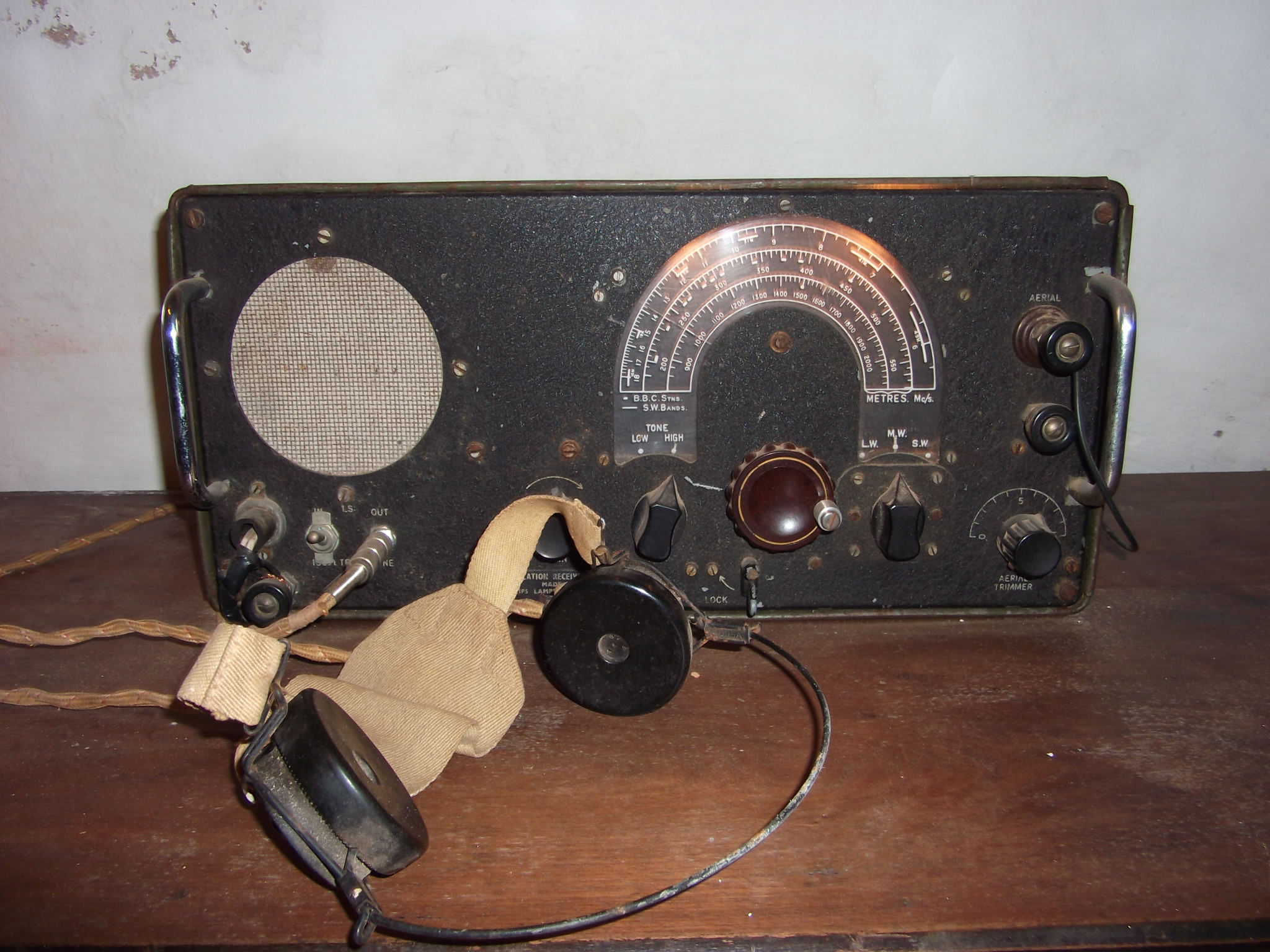

Anyway, enough of the anorak, here's the pics Rhino. 1) Ark Royal 2) Lancaster 3) Invasion receiver usually now called Naafi receiver since they ended up playing music & news in the canteens. 8)

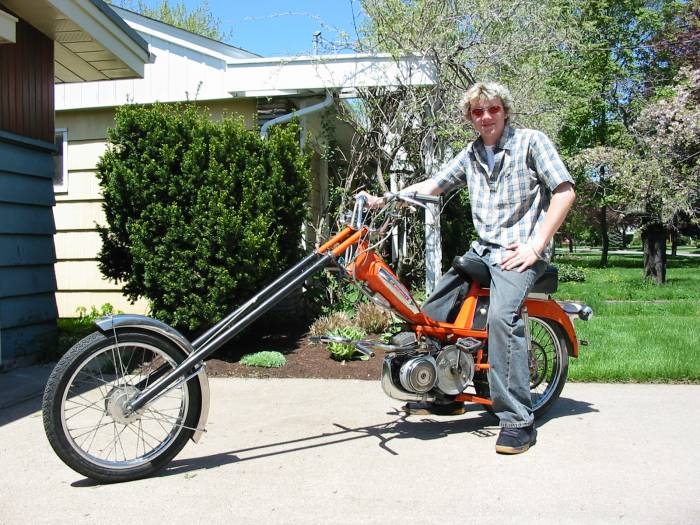

Almost forgot - there is even one for Chalks :? Can't remember where I came across this but I think it's US or Canada, check this out :shock:
I so Like it :mrgreen: :mrgreen: :mrgreen:

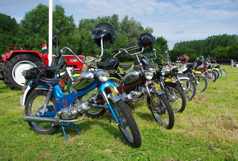

As we're showing mopeds, here's some I spotted in Holland last year.
They are Tomos, made in Yugoslavia, later models where sold via Woolworths! Seems the Dutch had a penchant for extended bars.
