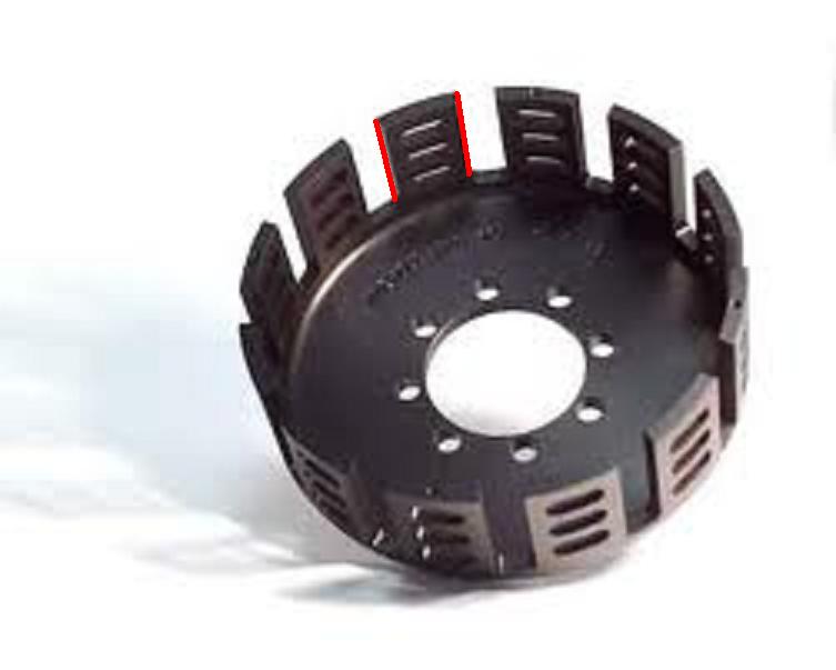

the edge of the basket where the fibers and plates touch are ruff and hanging up
where the red marks are also in the groves in the middle
or one or more of the ears broken off

just have to have a look
sounds like some thing hanging up and making clutch slip
that edge where i put the red mark can some times be filed back smooth and made to work
from what your saying sounds like some thing is sticking and making it slip
or you have some very weak springs
check also the sprocket on the transmission to the rear wheel
is the nut tight
the sprocket may be falling off i have seen this more than once
a clutch cable thats partly broken in the cable housing can hang up also
