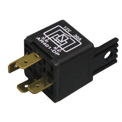

Postby DAVID THOMPSON » Fri Jun 28, 2013 2:26 pm
take a look inside may need cleaned and some one that knows how to solder electronics
rework the circuit board
if its lived in an area where humidity is high it may have some bad joints in side
also check the relay 19 and relay 30 articles
this relay supplies power to the whole bike
it's relay 30 on the 660 bikes drawing
relay 30 powers the ignition unit it may seem to run ok
but the tach does not like the power being supplied so it goes nuts
on my rt125 the tach acted up for several days
then bike died
sorted it to bad relay 19
after replacement TACH problem went away
the contacts in the relay went bad
viewtopic.php?f=4&t=2085
watch the spade lugs on the wires they get weak and do not grip the wires
they also break off the wire ...wires in side the covering turn to green slime and all thats left is the covering

Postby UNNA » Fri Jun 28, 2013 4:03 pm
Thanks for that. I do live in moderately humid part of northern New Zealand so I will replace the relay and take the rev counter in for service. Is there a part number for the relay and where is the best source of them?
UNNA
Posts: 17
Joined: Fri Jun 28, 2013 2:54 am
Re: Skorpion rev counter problem
Postby DAVID THOMPSON » Fri Jun 28, 2013 5:34 pm
its a standard light relay available at most auto stores
and a bit larger in physical size than the stock one
this one is 4 pins
the one i have is i think 5
