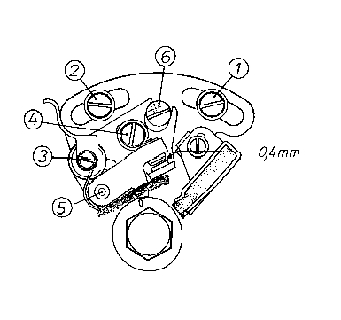

Have you set the maximum gap first? Rotate the engine until the points are as open as they will go then adjust so the gap is 0.3mm ( or 12 thou in old money) . I'll dig out a picture when Ive had me tea!
Contact breaker.jpg (65.88 KiB) Viewed 3857 times
Turn engine to give maximum opening of contact breaker
Loosen screw 4 then turn the eccentric 6 until the gap is 0.3mm ( or oddly Ive just noticed 0.4mm on the diagram)
Tighten screw 4
Then adjust timing by loosening 1 and 2 and moving the backplate
Then probably repeat!

Hi, yes, did set the points gap first (thank you for including the pic' though). I've no reason to suspect the operating cam has moved, though will try and check that tomorrow.
