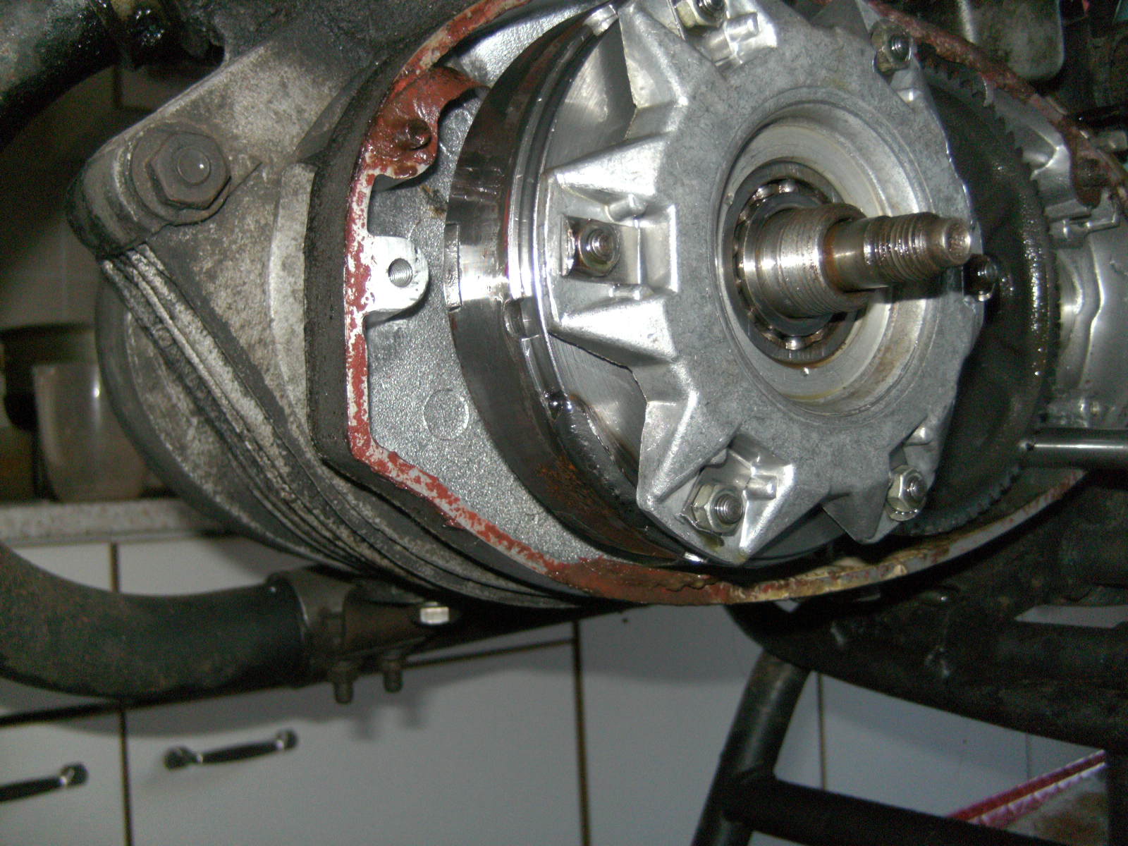

Cheers for the info. Don`t know how i missed that about the 150. Here i hope are the pics of the welds. (Smashing welding).
Bullgoose.

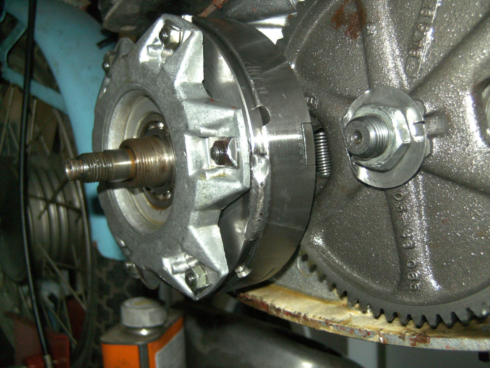

Postby bullgoose » Fri Nov 22, 2013 11:36 am
Photo No 2

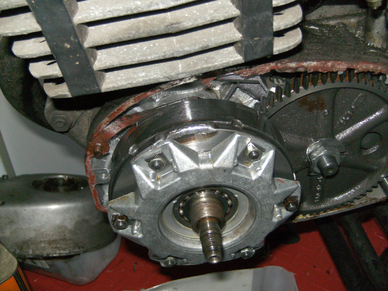

Postby bullgoose » Fri Nov 22, 2013 11:37 am
Photo No 3

Re: 1979 TS 150 & crazy weld on a 250-1
Postby therealche » Fri Nov 22, 2013 4:12 pm
Well it's original. I'll give you that!
I am always amazed at the abuse MZs seem to shrug off. A great friend of mine bought a Supa5 for a pint and a sandwich. He rode it back from Hampshire to West Yorkshire and it sounded like a cement mixer. You could hear it coming from about half a mile off. he decided to just keep riding it till it finally died, but a year later he admitted defeat and sold/gave it to a mate. I think it ran for another 6 months before the new owner decided to rebuild it anyway.

Postby bullgoose » Fri Nov 22, 2013 8:00 pm
I don’t know why someone who can weld that cleanly did not have some kind of mechanical sympathy. I bought the bike unseen from someone in the British owners club via a mate for £40 a good few years ago now, and he brought it up north on his trailer from Hertfordshire. I did start the bugger up after replacing a broken carb needle - putting the coil feed the right way round and tightening up the primary cover which was full of clean rain water. The mains sounded dreadful (Like a ball bearing going round in a dust bin lid) so I put it away until I could be arsed to do something about it as I have next to no knowledge of MZs.
Postby DAVID THOMPSON » Sat Nov 23, 2013 12:27 am
can some one shed light on the purpose of the deluxe welding JOB
ruff way to replace a bit of Loctite
