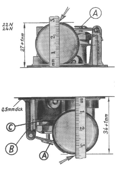

Float height is 27mm when 'closed' and 34mm when 'open' - see attached.

I notice that my carb hasn't got a float bowl gasket which could be a contributory factor.
All the original air filter gubbins has been removed and replaced with a jubilee clip on one that fits on the end of the carb, looks nice but probably not helping either!!!
I have stripped the carb so I will measure the float heights and check exhaust joints and head gasket for leaks too and get a gasket for the carb from somewhere ? :?:
